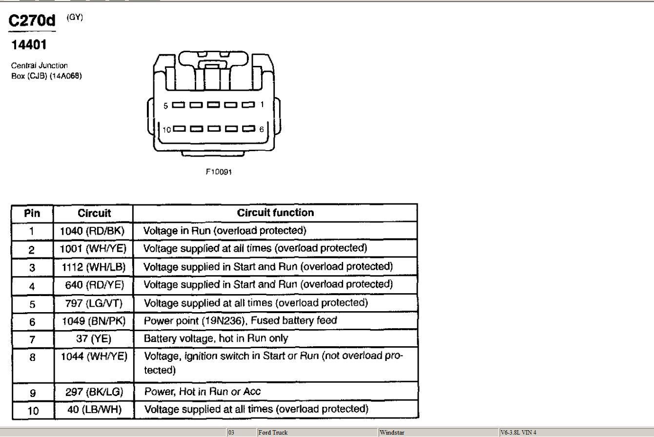

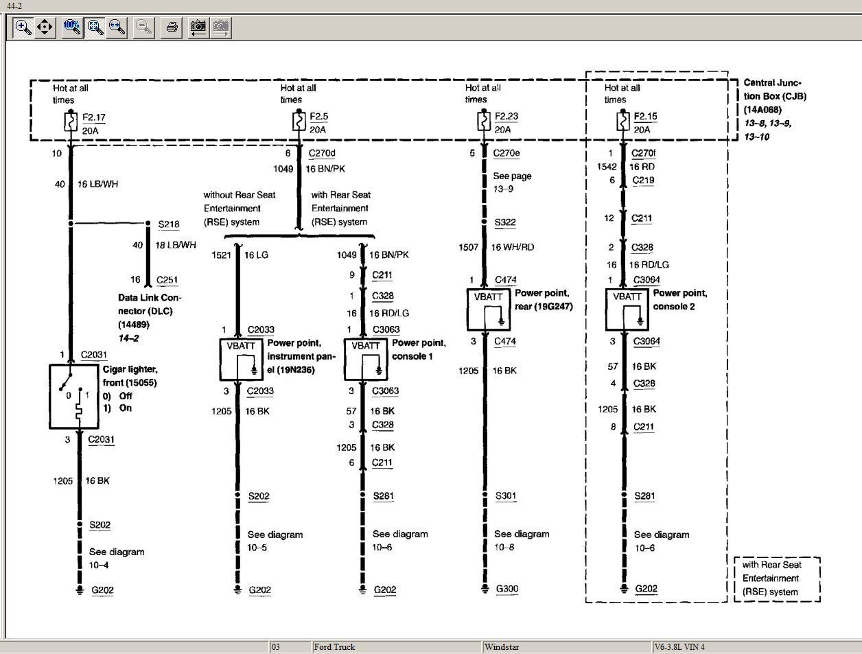

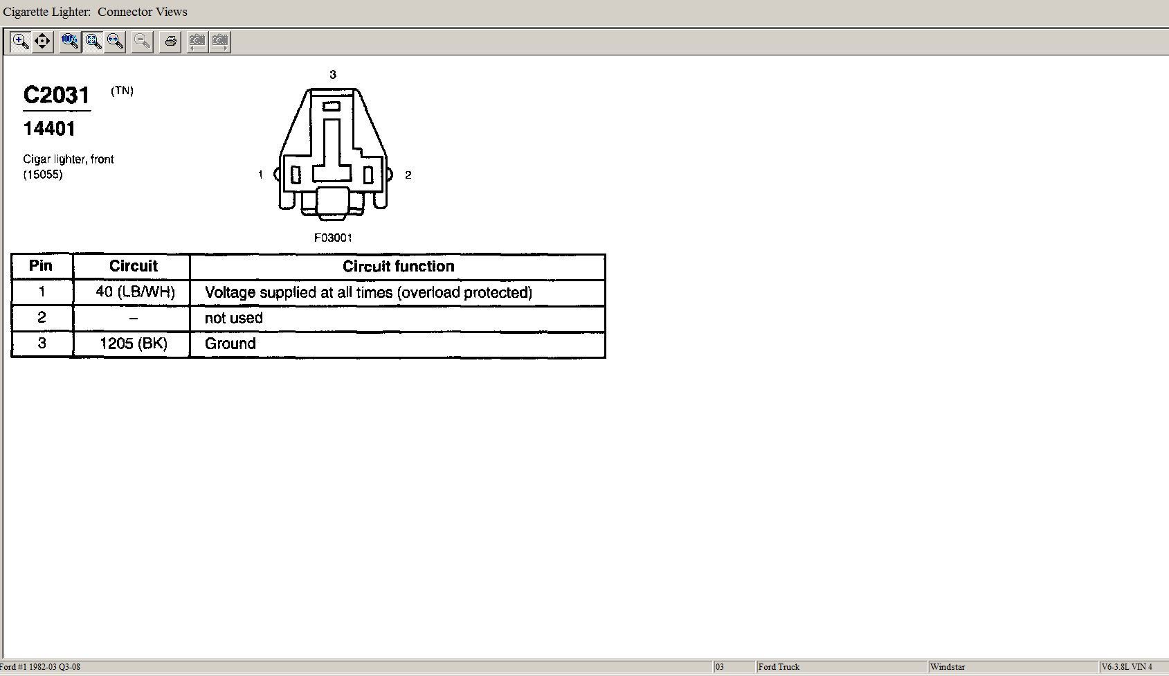

Posts: 1,254
My alldata software pulled up only V6-3.8L on 2003 if you take a look at bottom of the diagrams that I posted you can see I got that right.
The misbehaved pedal is very important and require immediate attention, you should not drive it further until it's really fixed, but then the short to ground on your cigar lighter circuit is easy to fix so I suggest you to go over that first, it's pretty simple circuit you start from C270D.

First off—GOD BLESS you my friend. When a new car isn’t yet an option we make do with what we have. I’ve personally swapped so many parts on this car I’m on autopilot through most repairs. I’ve got homemade tools just for this vehicle’s maintenance. I swapped engines, transaxles, suspension and steering parts; I’ve even removed and repaired the entire engine cradle where it had been bent(which included cutting, welding, grinding and painting). I’m about to flush my steering system before a long 8hr drive from NY to NC. The one thing I’m not at all proficient in is reading and implementing electrical diagrams. Are those circuits germane to my application surrounded by the dotted line? Is that the junction box in the engine compartment or under the dashboard. Just so it’s understood, this vehicle had no luxury features(base model)

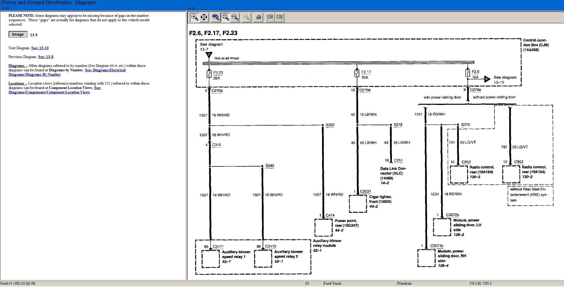

Here's an EXAMPLE of power and ground distribution:
So C270a here is equivalent to your C270d, the so-called current flow starting point in the diagram.
The CJB location below:
I doubt your datalink circuit is at fault and I think your cigar lighter probably since it's most used, you plug and unplug daily, and by design on all cigar lighter sockets the + and - are very close to each other and it's easier to get your short there than the middle of the circuit.
