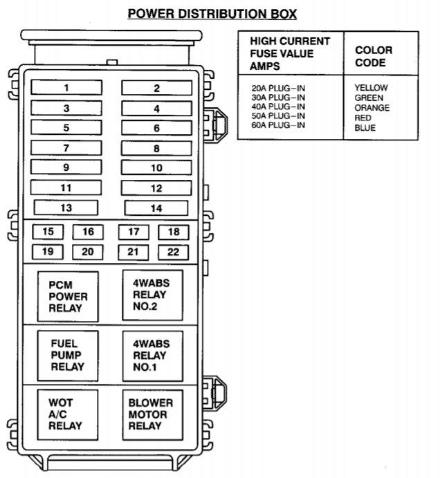

on my 91 explorer eddie bauer editon there are relay under the fuse box in the engine compartment the owners manual says nothing about them. what do they do?

So the online workshop manuals stop at 1992, but the 1992 explorer doesnt have a picture of the relays, just of the fuses.
Here is the best I can give you, its from a 1993 explorer, I am not promising this is the same as the 1991 though.
If you are talking about other relays I would recommend posting a picture of the fuse/relay box locations for us to see what you are talking about.
