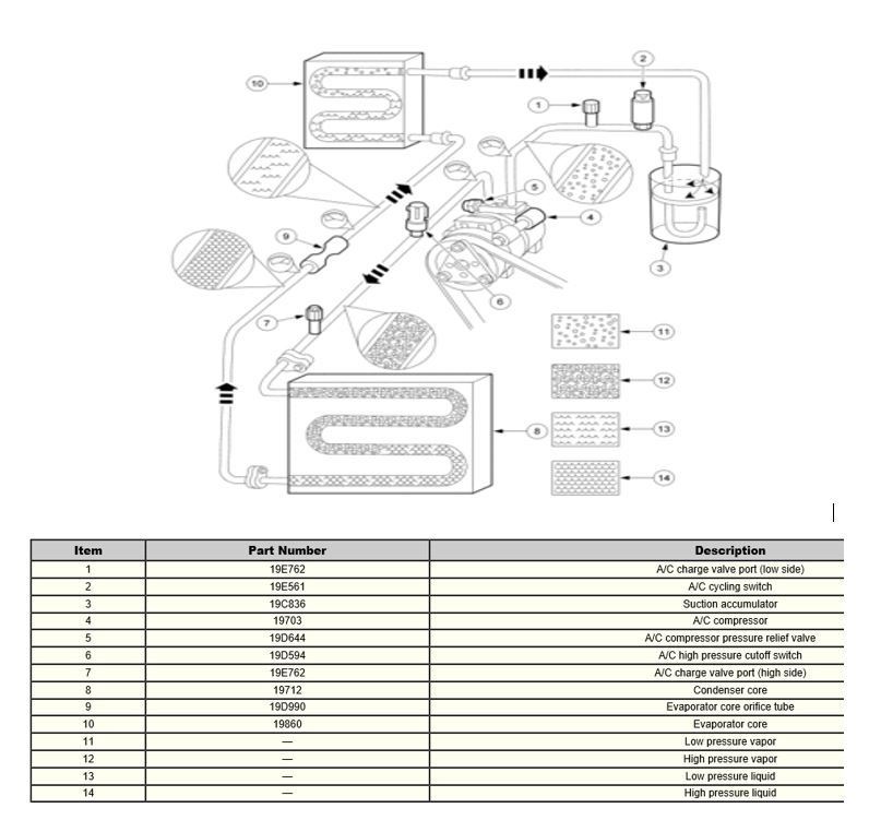

Update: Issue A/C not blowing cold in the front (warm Drivers side/Semi Cold Passenger side) and Cold in the rear (DATC).
I hooked up my gauges, and this time I measured the high side. In retrospect I should have checked the high side sooner. My reading are 225psi (high side)/ 50psi (low side). According to charts my problems might be:250 PSI / 30 PSI = You have air somewhere in the system.
250 PSI / 50 PSI = The system is overcharged and the condenser is not cooling. Condenser may be blocked.
The A/C line that the High side is attached to is definitely hot.
my next steps are to rent the required tools to drain the A/C system and flush it. I will also replace the accumulator while the system is empty.
I should have checked the high side sooner, I thought since the refrigerant was low in the beginning it just needed to top up.
Anything else I should replace when the system is empty?

My question is when Flushing the A/C system, what parts do I avoid? I will disconnect the A/C compressor and accumulator (replacing). anything else that can't be flushed? Any good write-ups for a 2005 Ford Explorer with DATC?
I did a search in this forum and can't find a A/C Flush specifically. Any components to avoid flushing?
Old Aug 15, 2020 | 04:14 PM
Higgs11's Avatar
Joined: Jun 2020
Posts: 7
Going to change the condenser as well. Looks to be the original and the system is discharged (empty).
Does anyone know what the yellow vacuum hose under the center counsel controls? seems to disappear into the center of the box. I traced all the other vacuum hoses to their locations and all work as designed.
I also put a vacuum line on both high/low A/C ports. went below zero and stayed there. no apparent leaks.
