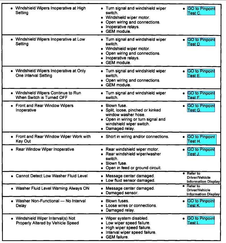

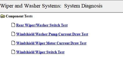

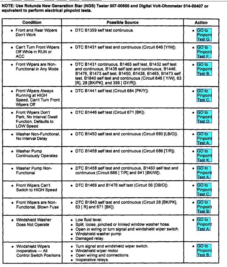

Hello All- my 95 Explorer's wipers only work on high. It's not the motor or the stalk on the steering column.
I think its teh computer used to control
interior electronics-
Can anyone comment on this?
Thanks,
Rick
Old May 27, 2025 | 12:40 PM
Posts: 1,254
