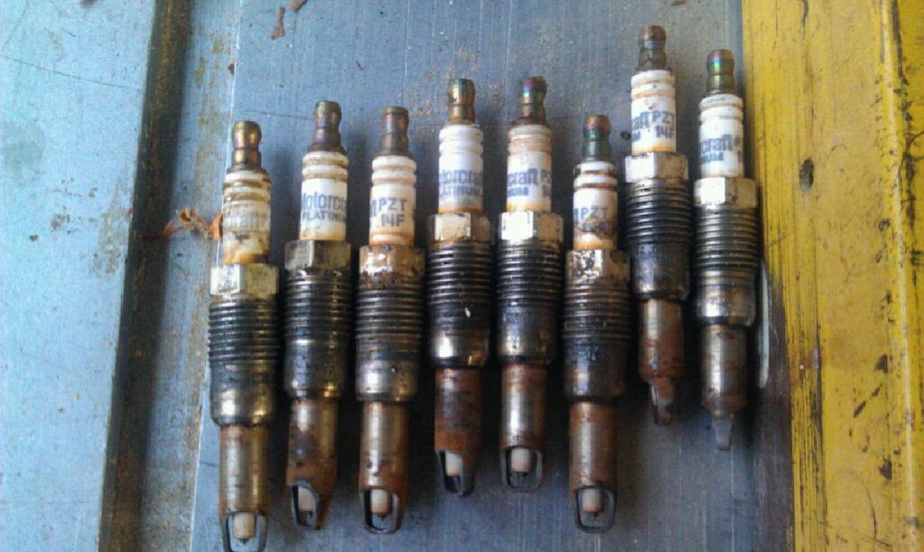

Here's a fresh set pulled.. Hope yours are smooth coming out,, and A Mery Christmas to you and yours as well..
