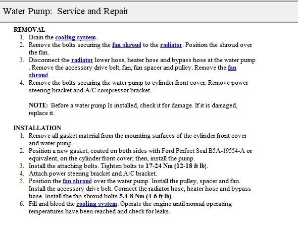

Since you said the water pump is not thoroughly checked, so check the instruction below.

Heiko... It just dawned on me that the vehicle I installed a new water pump on some 20 years ago was my late wifes 1989 Crown Victoria... NOT this 1988 Ford F150. This dawned on me when I found that the AC Compressor and the Power Steering Pump retaining bracket was over top of a portion of the water pump (sigh). I've got a good excuse... guess what it is!
So, bottom line is that this water pump is is a good 36 years old! My Haynes manual that I bought in 1988 has swelled with humidity to where it is about 1-1/2" thick now, but still going strong. It says to remove the retaining bolts of the AC Compressor and the Power Steering Pump... HA!, the P/S/ bolts are in back of the pulley. Why did I ever loan my puller to my neighbor who was in the process of moving? New puller will be in Saturday (5th). No Idea where the retaining bolts are for that bracket. Ford actually designed a heavy duty holding bracket to go "Over Top" of the water pump??? Does it get worse or better? I'm so glad I'm doing this myself.
