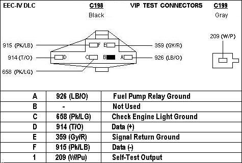

Thanks to both I will let him know, he was thinking maybe throttle position sensor. But unsure that make it act like that. Is there any kinda of way to access codes that it might have. I know it would be an obd1 but is there any other way to manually access codes on that particular motor where it might give hint to what’s maybe going on?

Or you can just use a jumper wire in the diagnostic connector to read the codes.If you search "using paper clip to read Ford OBD 1" the procedure is described.
