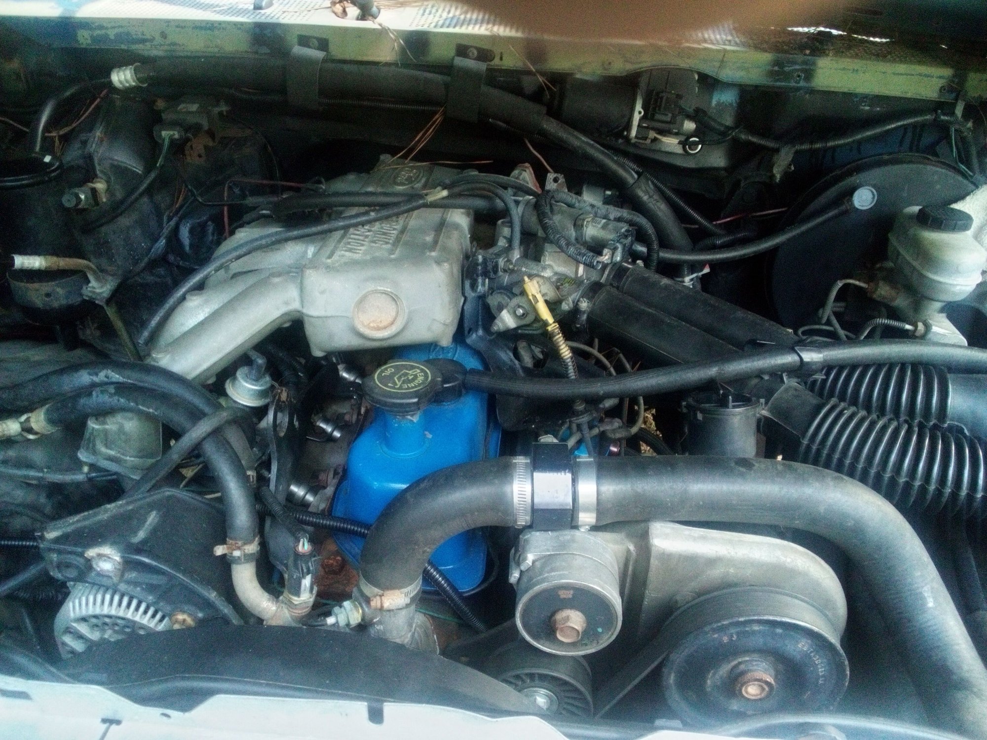

1993 F-150, reg. cab, 4x4, 4.9L, AT (E40D) manual 4wd shifter w/locking hubs: cranks and idles, engine responds to gas pedal (revs up) when in P and N. However, when in R or D no response to gas pedal manipulation (will not rev up/idle only). Any suggestions appreciated

I bought this truck "as-is". Previous owner had invested in many upgrades and I believed it had potential. To-date I have replaced ECM, shift module, fuel pressure regulator, fuel filter, ABS speed sensor, knock sensor & throttle sensor. Fuel pressure at idle is 40psi.
