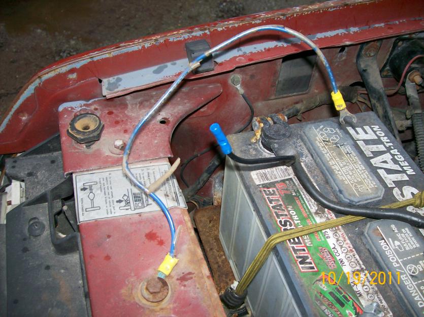

i do have 2 wires by the battery. one is a ground and one is just hanging off one of the clamps. the one hase no lead to it anywhere else and i never remeber it before like that but i have no idea where it goes and i do have a test light and will try your suggestions. thanks

You might want to check that dangling wire and closely examine the positive battery terminal or the negative terminal and (if the terminals are original) look for a broken connection. It might save you some time determining where the wire came from.
It could also be one of the ground wires to the sheet metal of the vehicle. Look around for the terminal with no wire connected to it.
After looking at your pix,that is an additional ground wire that should be connected to the negative terminal of the battery.

I should have checked your pix first. That wire is an additional ground wire that should be connected to the battery negative terminal.

so the blue wire is the ground wire but i cant find any other hanging wires anywhere elses fror the black wire.

The black pigtail on the negative battery cable is a lot of times 'standard' for a replacement ground cable. Depending on application, sometimes they are just nipped off, but you could extend the wire over to the fender appron ground attacment. You don't normally see a ground onto the radiator core suppport and could be just removed.
