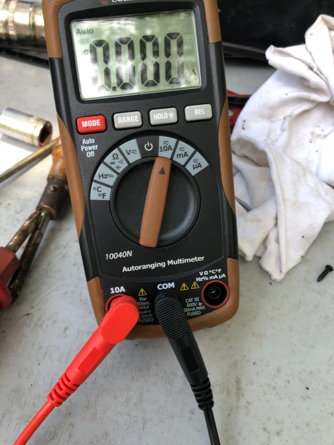

I’m fixing to look for the battery drain problem. To restate, the hot fuse is no longer a problem. The problem now is strictly a slow battery drain which, overnight, completely drains the battery. The battery won’t even do the ticking sound. I’m gonna try unhooking the negative battery cable, and put my meter in between the negative ground terminal and the negative ground cable. Using the 10A setting on my meter and making sure I move the red meter line to the 10A socket on the meter. Then I’m gonna pull each fuse from both fuse boxes and see which one affect the amps. (Is this correct?)

I hooked up my black meter cable to the ground terminal and I hooked up my red meter cable to the ground wire. I made sure the meter was set on the correct position and that the red line was moved to a 10 or 10 a whatever. I’m getting absolutely no reading I’ve done it several times but the reading stays at zero so then I read online maybe the fuse was busted in my meter. So I’ve got my meter taken apart I see two fuses but they’re completely white one has 10A on it and one has 600VAC on it. What do they look like when they are blown?

Part of the ground wire is still attached to the body of the truck or chassis I even took it off and cleaned that. Any suggestions why my meter is not showing any amps. I guess I’ll try it again and turn my headlights on to see if the meter goes away from zero

So with black line hooked to ground terminal and red line hooked to ground wire, and part of ground wire still attached to truck chassis; still got zero reading. I turned the headlights on. They would not come on. Reading still at 000. I unhooked everything and put ground wire back on ground terminal. Turned headlights on and they worked. Now charging battery again and getting some lunch. I’m doing something stupid bc the meter should read.

Is the connection maybe not good enough. Like I’m just ‘touching’ the ground terminal and ground wire w the thin prongs of the black and red lines. Should I attach it with like alligator clips?

Your fine posting here...
Fully charge the batt before testing..
Test the draw in mA first.
Set the meter/leads for mA. Anything over 50 mA is excessive,, normally.
A drain over night is substantial. Hot fuse/s is not normal.
After it sits on a cold soak, battery fully charged, place your hand on the alternator. Is the case warm?
If there's no 'add on' wiring or devices, then removing the fuses individually may shed some light and a direction...
Post the specific fuse number/location, and I'll look at its power distribution-routing...
