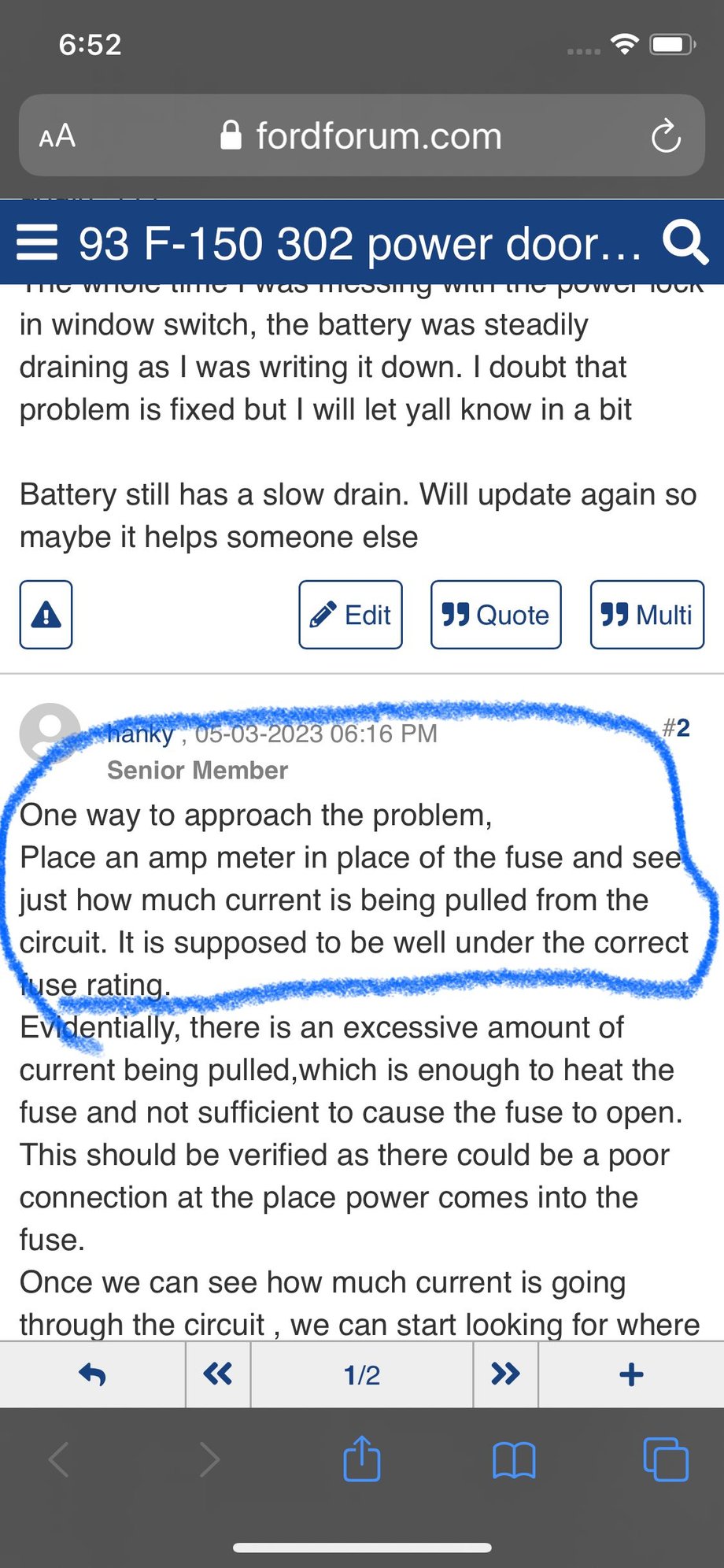

A meter is great for doing detailed testing,,,,,,,,but if the fuse in your meter is open and you are not aware ,it can drive you up the wall.
The only way to make sure those 2 white fuses are good is to test them for continuity. You can do this with a simple test light, but not with a meter that cannot function with a possibly bad fuse.
If you have any good 12 volt bulb,place one end of the fuse you want to check on the positive post of the battery, place the bulb bottom contact against the other end of the fuse , then provide a ground to the other part of the bulb. If the fuse is open ,the bulb will not illuminate. If it lites it is good. But you need to know your meter can work correctly or you could be doing what we call chasing your tail.

If your meter isn't working, for a couple bucks you can pick up a cheap HF meter. Or borrow one if possible. But like hanky noted, just a quick continuity test would prove them out..
Looking at your fuse/test data, we're seeing fuse numbered position, and a measured power distribution at the fuse?
Reading the meter amp draw at the battery, and removing one at a time should help isolate the possible power draw/s..
If you isolate it to a fuse, we can schematic check and see all that pull power from that fuse...

By removing the fuse, you remove the load side or draw as well on the circuit . You should see voltage distribution to one leg of the fuse depending on the key position, and/or circuit activation (items switched ON) . But the load on the other side of the fuse socket won't really be a readable value as far as amps..
The collective 'resistance' on the load side of a fuse,, meaning for all the electrical features or hardware (as a resistance=load) on each fuse would be pretty much an unknown., especially if any add on equipment or harness splices etc.
The best way to check for a parasitic draw is measuring the mA draw and its amperage "drop" (if any) at the battery/cable as each fuse is removed.
