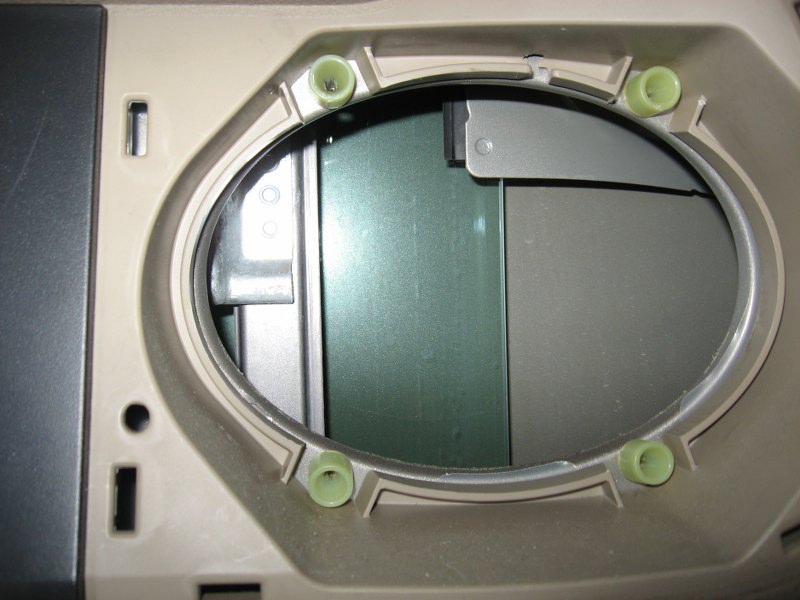

My driver's side power window quit working Aug 2010. I let FORD fix the problem. Now April 2012 the problem returned. I checked on line and decided I would fix it. The butt end of a cable broke loose from a plastic slide. To take off the door panel, which slides up, I removed 5 bolts. I also removed the speaker mounts that poke through square holes and I rounded them off so the speaker screws just spins and does not tighten.
Now that I'm almost finished, I cannot find NEW speaker mounts. The FORD parts guy said that I have to order the speakers to get these plastic mounts.
Can anyone help find 4 speaker mounts?
Attached Thumbnails Driver Side Window Issue-img_0530_800x600.jpg   Driver Side Window Issue-img_0608_800x600.jpg   Driver Side Window Issue-img_0574_800x600.jpg   Driver Side Window Issue-img_0578_800x600.jpg
Old Apr 13, 2012 | 07:49 PM
Is it possible to use a little "JB Kwik" weld to secure the plastic anchors ? They will never give you a problem once secured will they?
