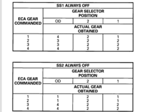

Gererally a high range start like 4th is related to shift solenoid SS1 always OFF, or mechanically stuck, or a harness/connector issue, possibly PCM but normally no. But a pinpoint connector check for PCM, control/application may help rule out drop out, internals etc.
Any missing or inaccurate speed input can cause long extended out shifts/shift scheduling issues, harsh or forced shifting. But should be a normal start out pattern.
OD light not working was fairly common for the harness to chaff at the shifter root and short to the column base, or, the switch itself. But with no button control, I'd suspect the harness, and then on down..

Had the wrong application image posted, always OFF is there..
The solenoids are always relay energized with the PCM in control of specific solenoid grounding for applications. Might check to see if SS1 is being grounded,, Orange/yellow-pin 3 in the trans connector.
SS2 is P/O for ground control..
