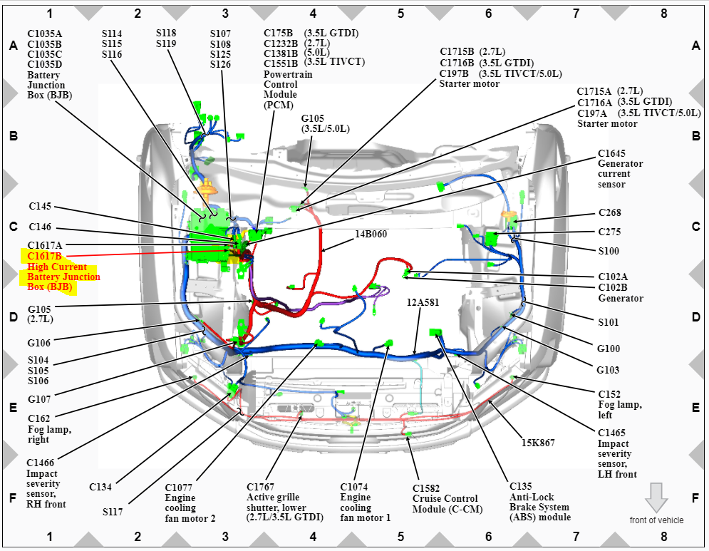

OK so 3.5 ecoboost.
What happens when you turn on key/try to start, does anything light up or anything?
Check that your two high voltage fuses that go to the battery junction box are intact.
