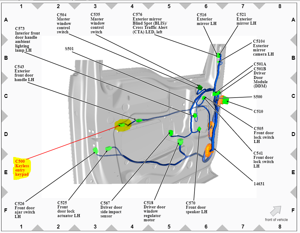

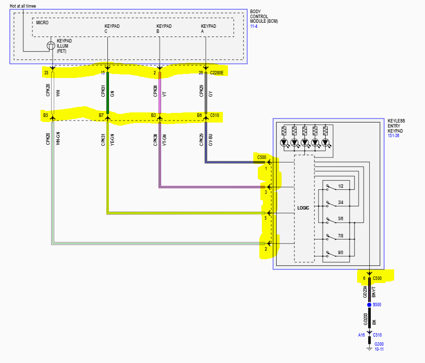

Heres the factory wiring diagram, connector views and placement on vehicle. Test the wires from the keypad to the BCM. Let us know what you find.
