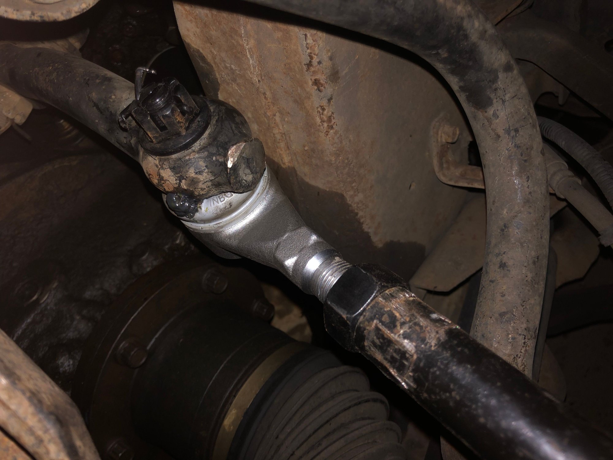

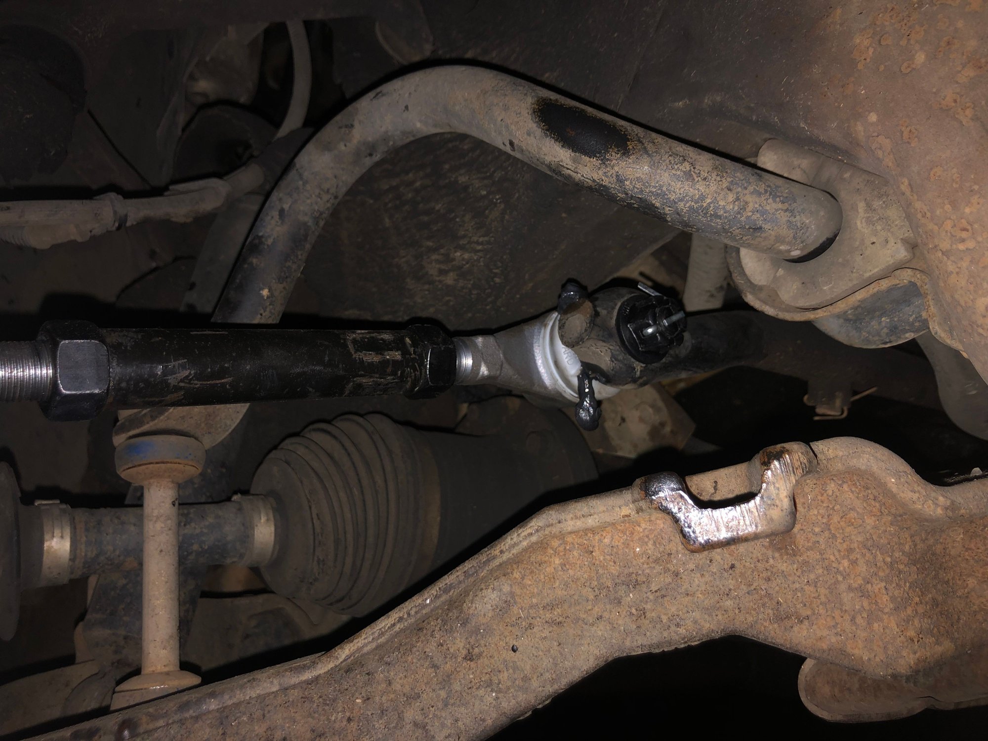

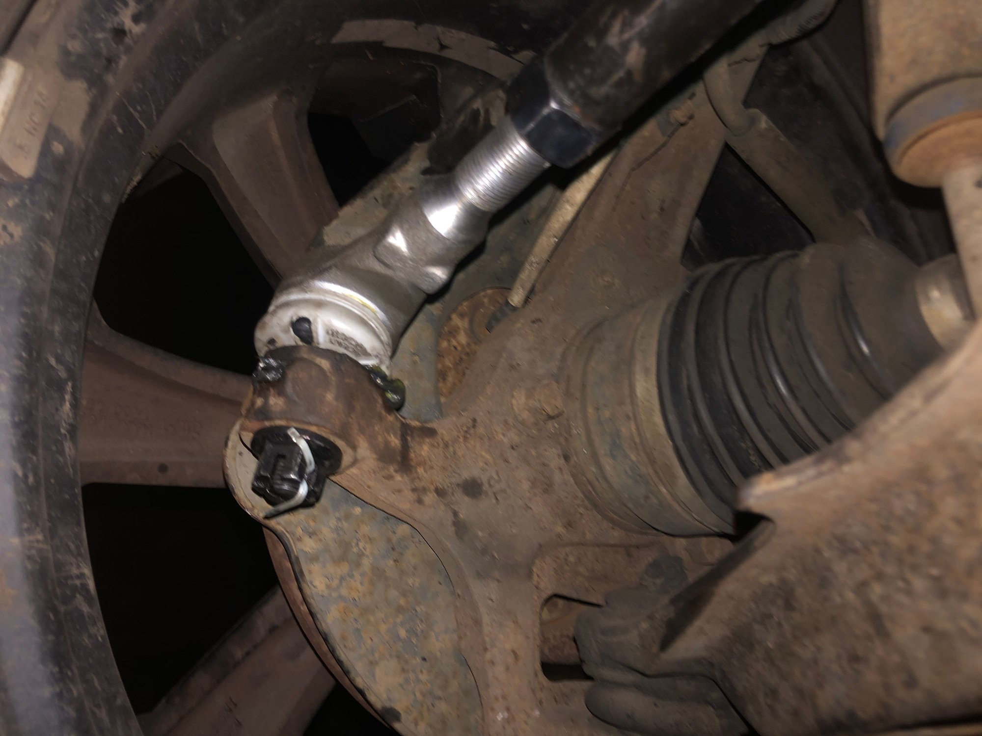

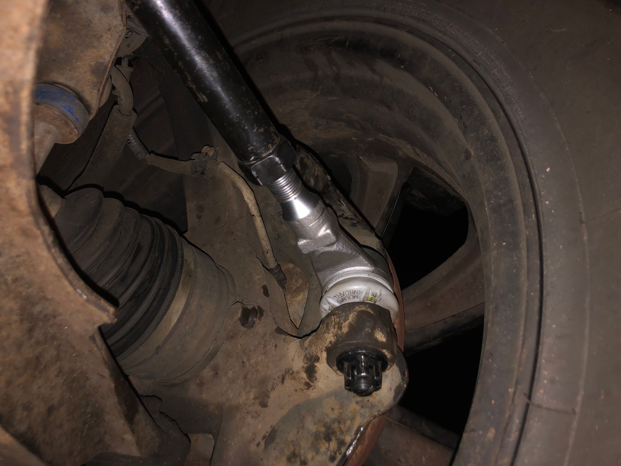

My 02 f150 had such bad tie rods shops refused to do an alignment until they were replaced. I replaced both my inner and outer and got them as straight as possible. Now my steering is squirrelly and my tires screech when I go anything above 30-35 mph. What could it be?
