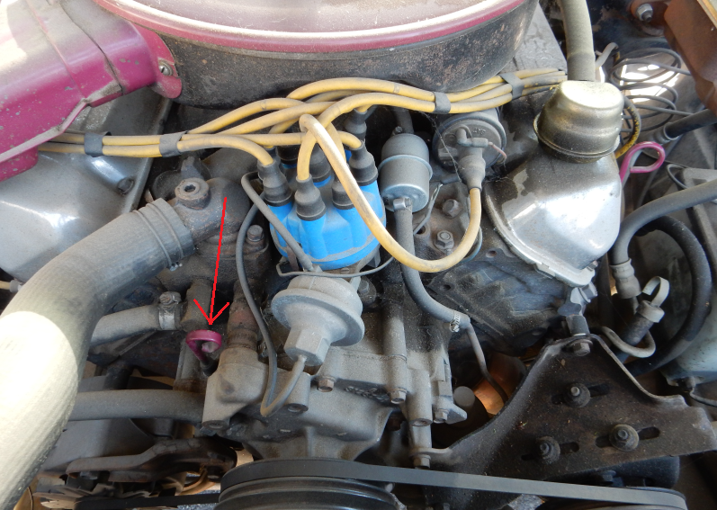

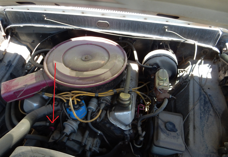

2. The oil level is good but there is a second dipstick that I don't know what it is and shows no fluid at all registering. I've included a picture pointing it out.

Since you have a dipstick in the front timing case, the engine is from a car or 2wd truck of the engine era as they used front sumps. 4wd trucks of the same era used a rear sump, so the dipstick was on the back side of the oil pan. In about 1983+ 2 & 4wd trucks all had rear sumps.
