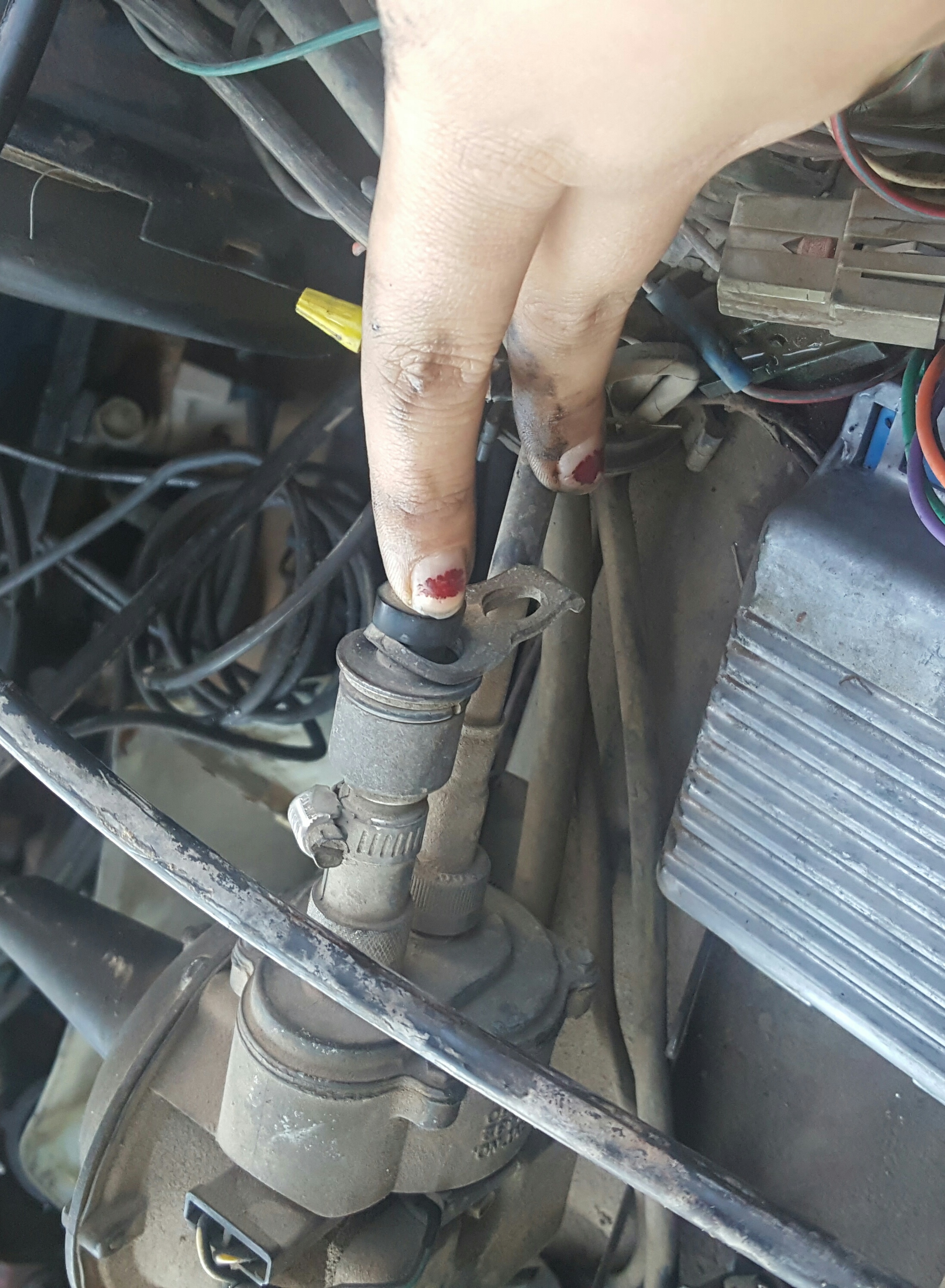

So it is no surprise to me that my speedometer cable broke, she's an old girl.
I bought a new cable and this morning I went to go pull the old one and install the new one.
The new cable is plugged into the back of my dash already, but I have not reassembled completely yet due to running into a bit of a snag.
I watched

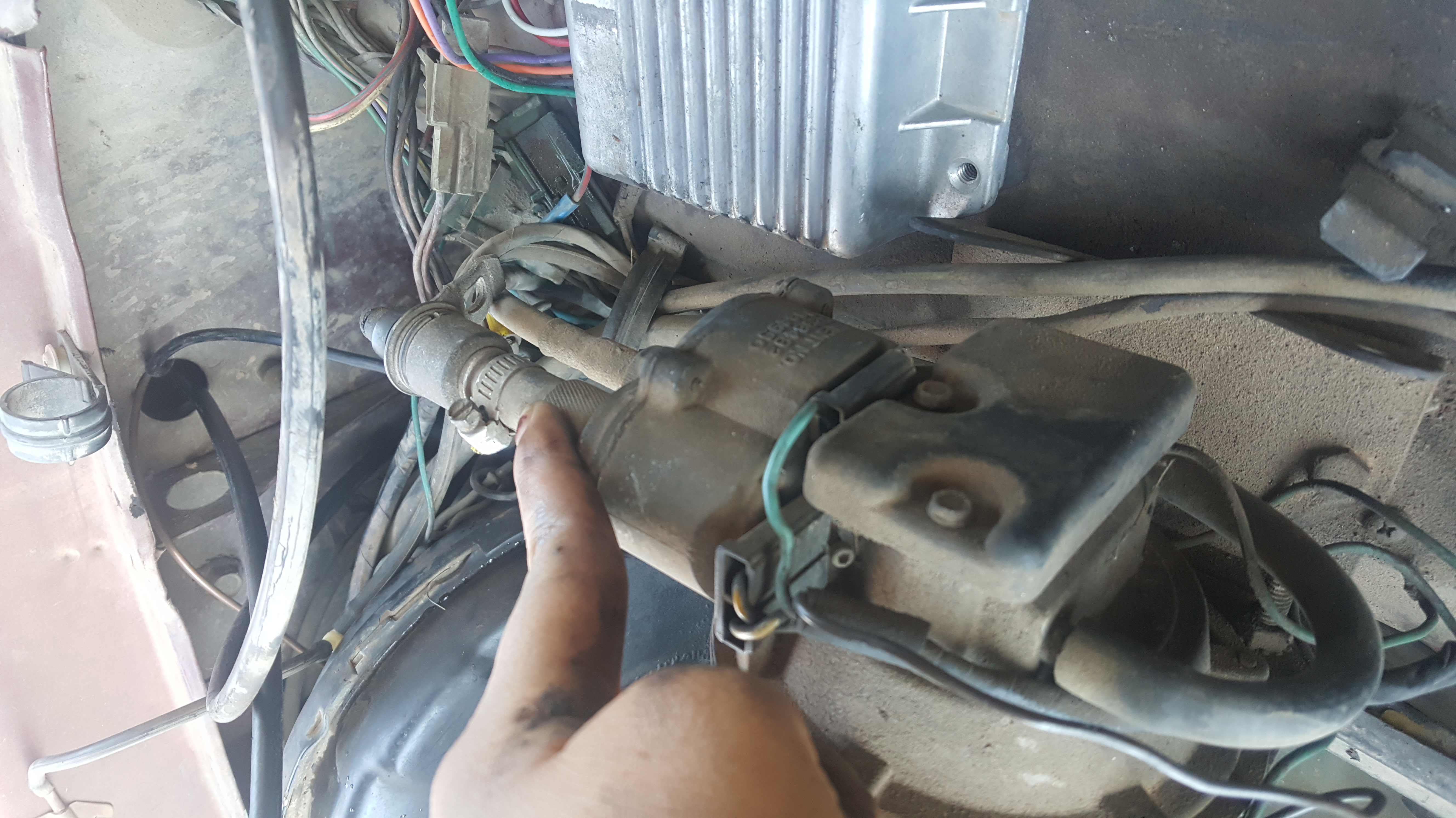

to get an idea of how to go about replacing this cable since I had never done it before. Simple. I thought it was gonna take me 10 minutes, maybe 30 because I am new to this whole thing. WRONG!!! I ran into something that it seems has TWO speedometer cables plugged into it. I need some help. Should I just bypass this part or try and continue to use it?
It has one cable from the transmission and another from the dash.
Attached Thumbnails 1979 F250 Custom, Need help with Speedo Cable Install-20170301_090538.jpg   1979 F250 Custom, Need help with Speedo Cable Install-20170301_090524.jpg

I bypassed it and the only problem I have had is that my new cable has SO much slack that it moved against the exhaust and melted. I could see my speed for about 20 minutes of driving. Haha, back to square one, waiting for AutoZone to get the new cable in and then running it in a new path.
Old Mar 1, 2017 | 08:46 PM
Thumbs up
The dual cable S/B for a cruise control transducer. Old Uhaul trucks used to have a 'speed limiter' transducer run off the two piece speedo cable that measured rotatio speed,, and throttle limiting would then be under control with a throttle position/limiting governor.
Sometimes the aftermarket parts aren't to spec as OE. Yeah, nothing more disapointing than doing a job twice..
