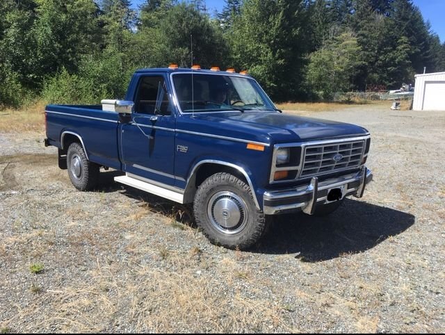

just picked up this truck and it ran great for about 2 days. All of a sudden sitting in the driveway idling it is putting out a ton of white/grey smoke that smells horrible. Think my neighbors were about to vote me off the block as the street was all smokey.. but at least i killed any mosquitos. Drove it around the block to see if warming it up would help but it did not and seemed to be getting worse with no power and running rough.
I didn't touch anything on the motor to cause this.
seraching forums i see anything from injectors to bad fuel to head gaskets...
wondering if any 6.9 or general diesel experts can throw out an opinion?
.. i cannot imagine it's related but i'll add in case somehow it is.... but also suddenly the tranny doesn't want to shift up into 2nd... lots of vacuum.. ordered a new modulator...
thanks for any help

Consensus is that the cloud is unburnt diesel. Cracking the injectors while running produced very little spray... so thoughts are that you are correct and the injector pump is likely faulty. He felt that the engine was starving for fuel.
Will also swap out the fuel filter on the off chance it's a disaster inside.
Good news is that a free replacement pump is available to me.
i'll update after the next steps

Follow up on this—-IP swapped out and truck is running great Smoke is gone.
