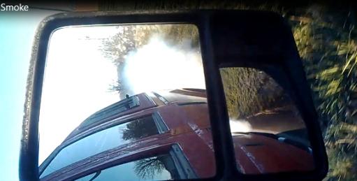

Thanks Hanky and Greasemark! Well I picked the truck up today from the local Ford dealership, about the 7th time it has been in the shop for this. Showed them the videos I made last week of the truck bellowing smoke from the exhaust and all they could say is WOW! They basically told me that there was an alert put out for the turbo cooler causing this issue. The part in question had already been changed on my truck and the Ford assistant stated that even with the new and improved cooler there was no guarantee that it would fix the issue. Something about being moisture because of the drastic temperature changes....blah.blah.blah.......They said there was nothing they could do about it. Thinking about plastering the videos of the truck bellowing smoke all over the internet in hopes that someone at Ford will do something about a dedicated Ford Truck person that paid $50,000 for a Smoke Generator. [ATTACH]

Even with the CAC upgrade the regen will most certainly be an issue,, not to mention 'your' liability for excessive smoke ticket/s (and fines) and anyone following in your pollution trail for potential hazards.. I'd go with a DPF delete, although warranty comes into play.. At some point there will be a class suit (if not already in the works) if engineering can't come up with a fix, and soon.. I can't believe the EPA/Air Quailty Management isn't already all over this...
