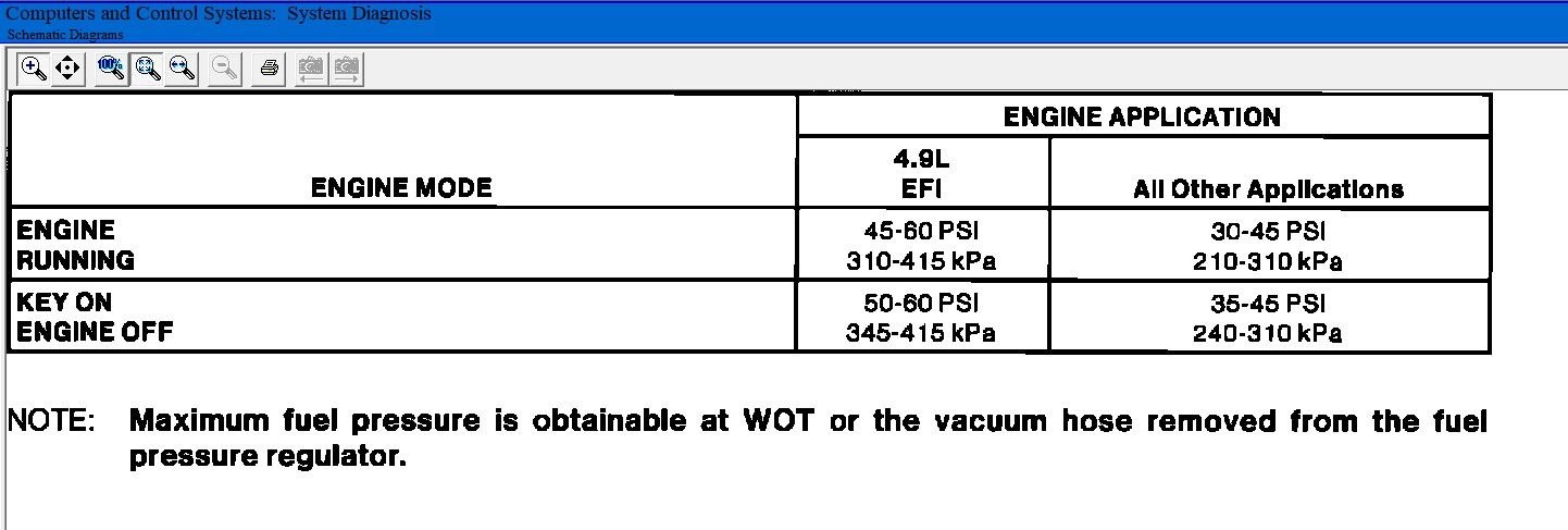

my 92 f250 7.5 won't start. I have checked spark(good) fuel pressure is 40 psi. I installed a new FPR and filter, map sensor, egr valve, pcv valve, ignition coil, new plugs and wires, new distributor and stator, and new timing chain and gears.

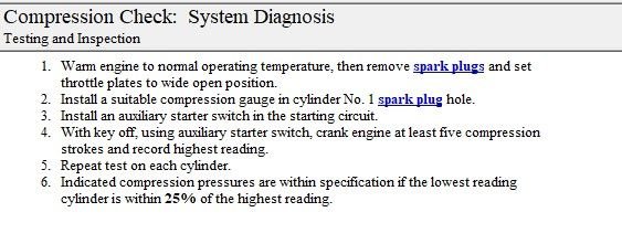

Just a quick update. I still haven't had the time to do a compression test on all 8 but I did brave the cold long enough to check cylinder# 1. Spark plug was dry. I used a screw in type compression tester, cranked it for 5 seconds and it showed 120 psi. Engine was extremely cold. I did this about a week and a half ago.

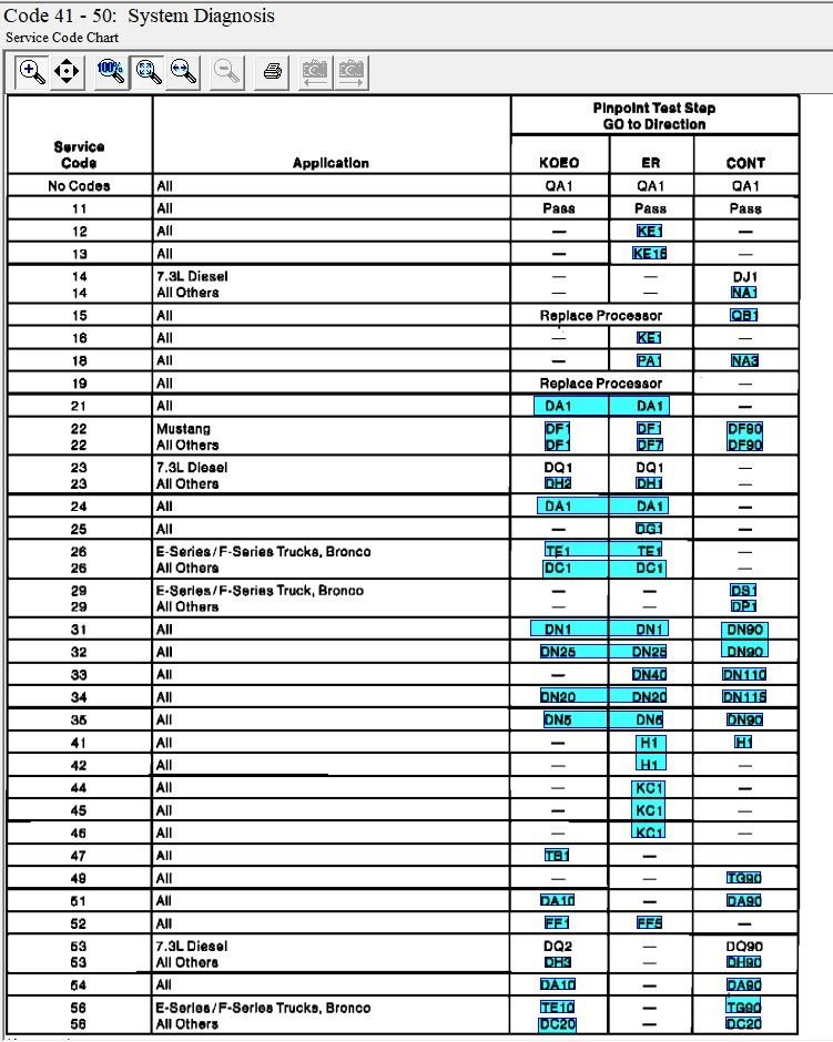

Today, I was going to do the other 7 cylinders but decided to check fuses then see if it would start. Fuses are good, It did start this time so, I put the timing light on it and set the timing to about 11-12 deg btdc. It does run a lot better now and the engine runs smoother but still sluggish. But while I was driving it around the property the check engine light came on. Code41. Just wanted to give you a quick update because I don't think this problem is solved yet. I'll be checking the compression on the other cylinders this weekend and I'll report back to you. Thanks for all your help.
Old Feb 5, 2025 | 11:04 AM
Posts: 16,628
The code 41 tells us the oxygen sensor is reading lean. It could be stuck lean due to a malfunctioning sensor or unmeasured air is getting into the cyls that is not being reported to the computer. Look for a vacuum leak, or a kinked/split pcv hose. Sometimes a hose comes off and is not easily spotted.
If the computer receives the information the mixture is lean,it will increase the injector on time ,,,up to a limit,,, which in this case has been reached and the computer cannot add any more fuel.

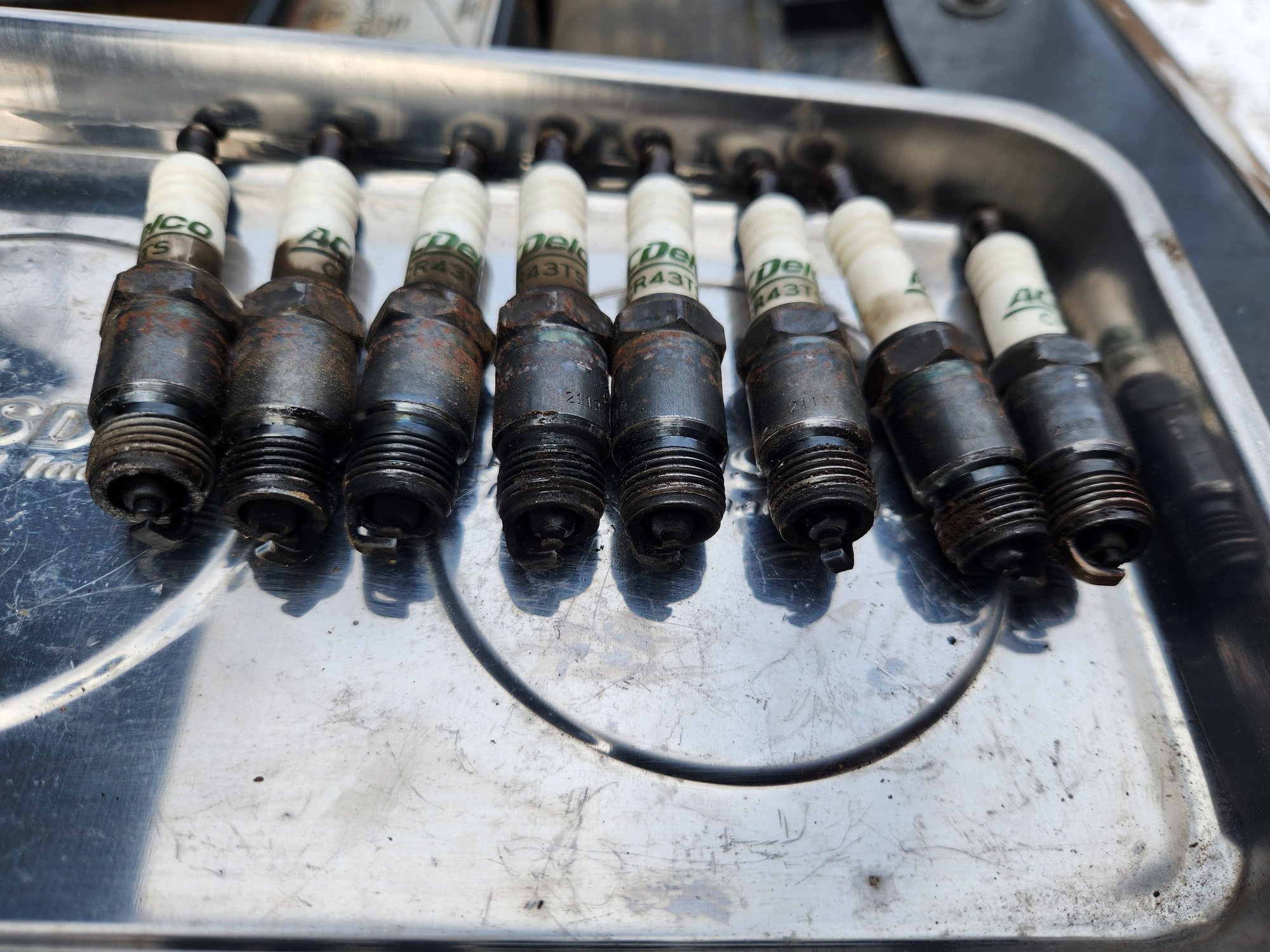

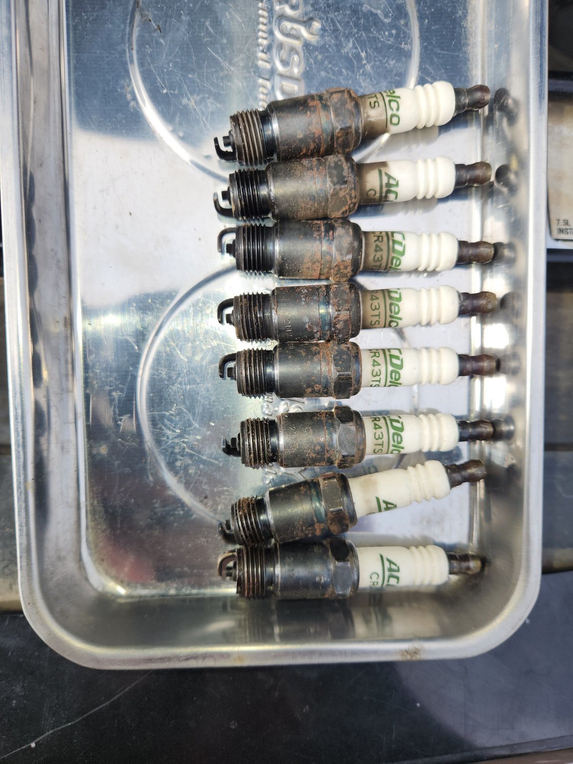

I did the compression test on all cylinders. When I was warning it up it was still running rough. I got it up normal running temp then took all the spark plugs out to do the test and all 8 cylinders tested at120 psi. I did follow the instructions you sent me. Thank you for that info. Number 8 cylinder smelt like gas, the others smelt like they were working fine. I attached a photo of the spark plugs. I put those in last summer and the truck has about 500 miles on it since then .
When I put the plugs back in and the wires back on it started right up, I was surprised it started that easily and was it running smooth so took that opportunity to check the timing again. It was off just little bit. I removed that gray plug by the test terminals and set the timing to about 12 deg BTDC. I took it for a test drive for about 25 miles and it ran smooth but still seems under powered and sluggish. That was a couple of days ago. Today, I started it but it took about 4-5 seconds of cranking to start. Code 41 is gone now and no check engine light. I feel like I'm chasing multiple issues
the order on the first Pic is left to right 8 -1.
2nd pic is top to bottom 8-1
I did check the gap before i put them back in.
Old Feb 14, 2025 | 04:30 AM
Posts: 16,628
The photo of the plugs removed shows a lot of black stuff which is not normal.
It looks like there is a lot of oil on them.If it is oil, we need to determine where it is coming from.. Restricted air intake could be one reason. That extra oil can plug the catalytic converter resulting in definite power loss.and also contaminate the oxygen sensor. Did you check the PCV system for possible restriction ?
That oxygen sensor will need to be replaced. You have a lot of work to do.When done let us know how it runs., thank you.
