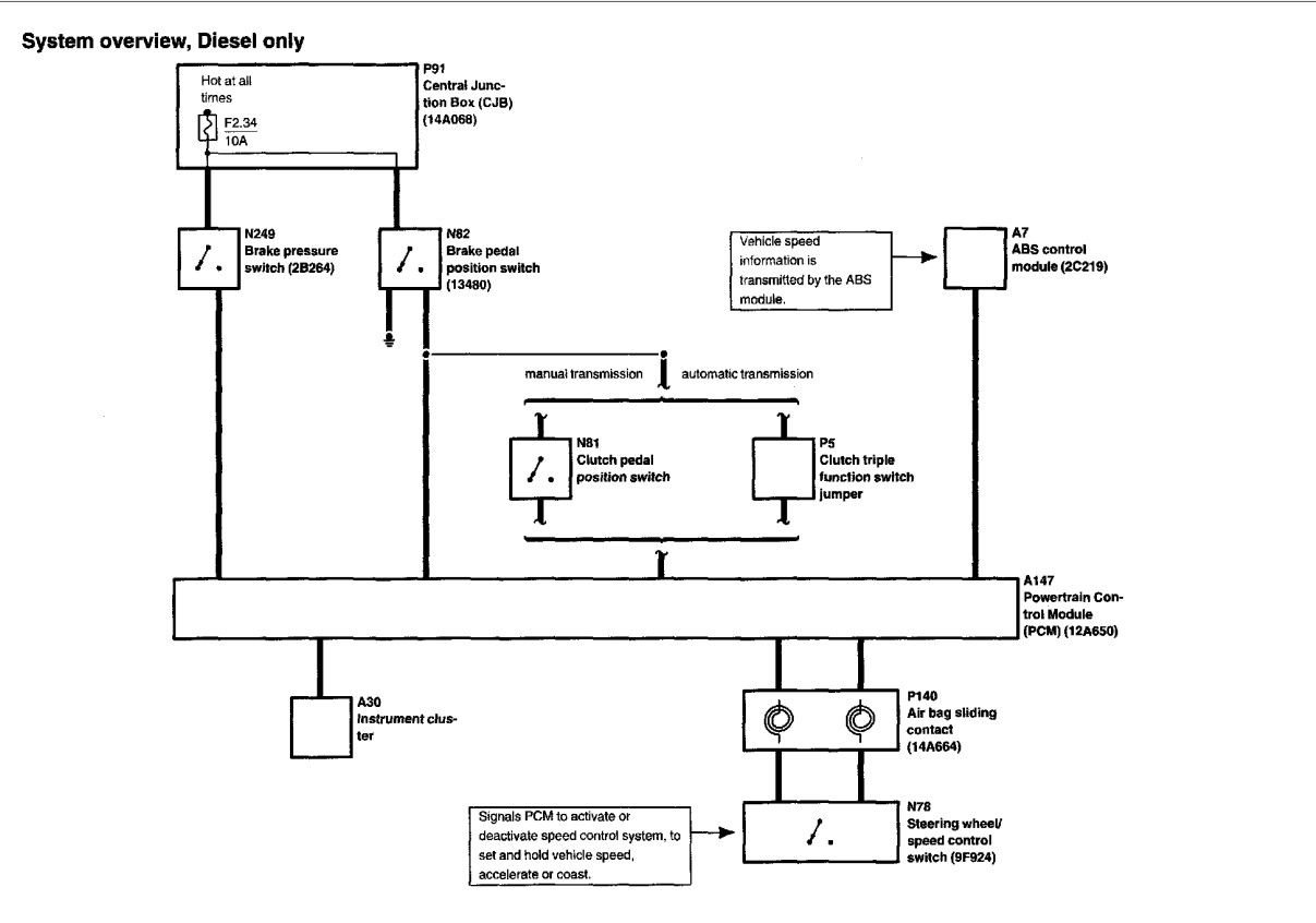

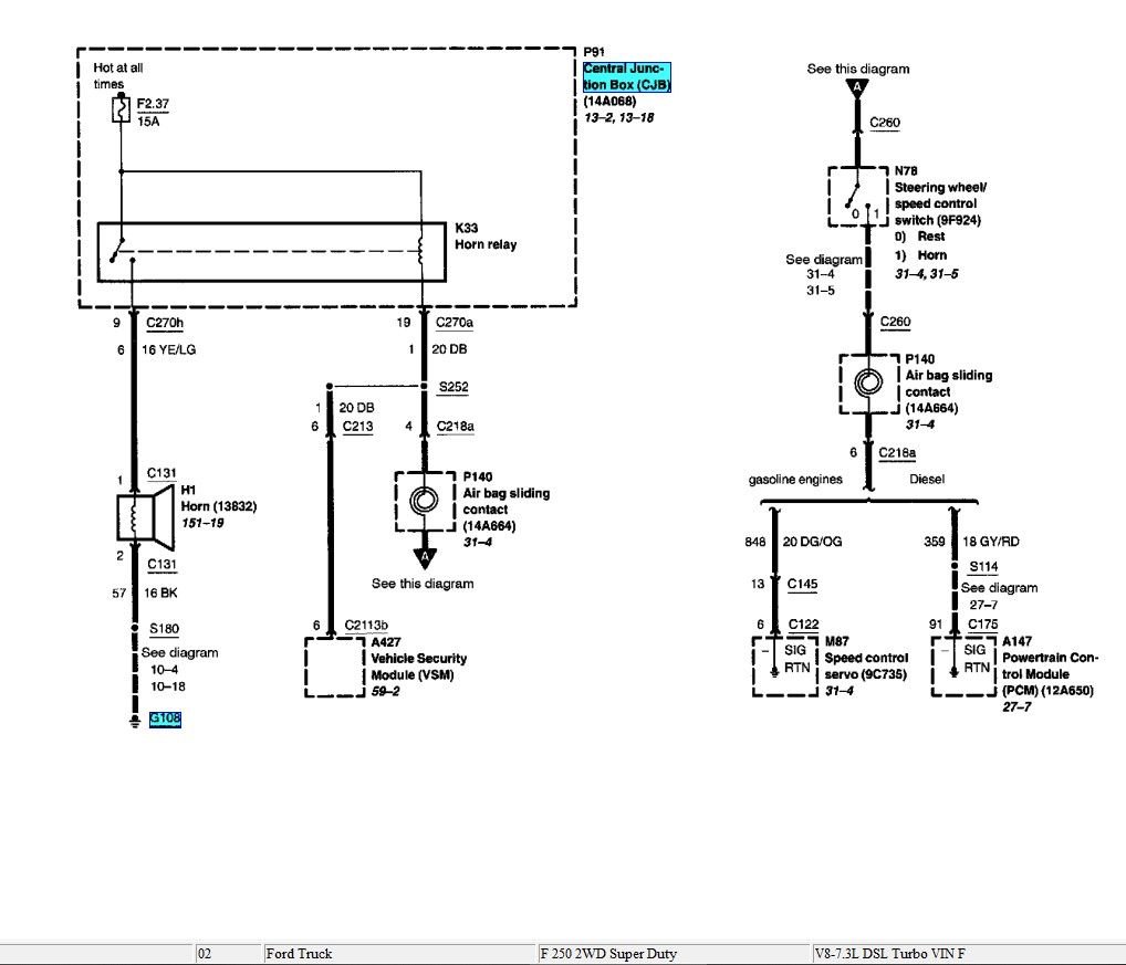

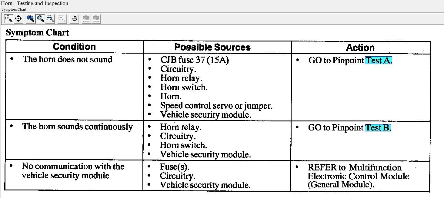

I would check on the horn relay first, borrow a relay (identical relay of course) within your own truck, then get to the horn switch and also bypass the horn relay, then you can narrow down the issue. All 3 are relevant, fix the horn first the other two could be fixed automatically.
You can tell by the very first diagram your horn button sends ground signal to energize the horn relay.

If K33 horn relay is integrated into the CJB you can still bypass it:
1) Remove the F2-37 (15A fuse)
2) Put add-a-circuit into F2-37 with the 15A fuse you just removed, add-a-circuit has 2 fuse slot so make sure this 15A is for the new circuit
3) Connect the wire coming from the add-a-circuit to terminal 30 and 86 of a new relay or a relay you removed from another vehicle

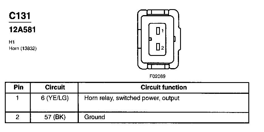

4) Run a new (same or heavier gauge) wire from terminal 87 of the new relay to the horn connector terminal 1 (YE/LG) using some sort of jumper pin without removing the horn connector, doing so you also don't have to worry about the ground (BK) wire for the horn
5) Locate the DB wire (circuit 20) at the CJB terminal 19, without removing any connector or cutting/splicing any wire, add a new wire using jumper pin to the DB wire, and connect this wire to terminal 85 of the relay
When the original 15A F2.37 is removed, the K33 horn relay is pretty much deactivated because of the lack of 12v power feed to terminal 30.

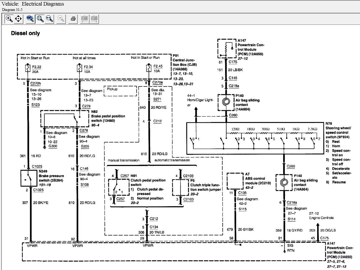

If this setup doesn't blow your 15A to your add-a-circuit you then need to narrow down the cause, it can be from 87 to horn, F2-37 to 30, F2-37 to 86, and lastly, the horn button thru clockspring to 85.
While you are at it, and since step (5) above already has a wire going to terminal 85, you can check this trigger wire and use voltmeter to check for any voltage (short to power), use ohmmeter and check for resistance for the DB wire circuit.
You also can bypass the clockspring to isolate the problem, you just need to connect the wire from 85 to a new horn button or a push button switch, and ground this horn button to chassis ground accordingly.
