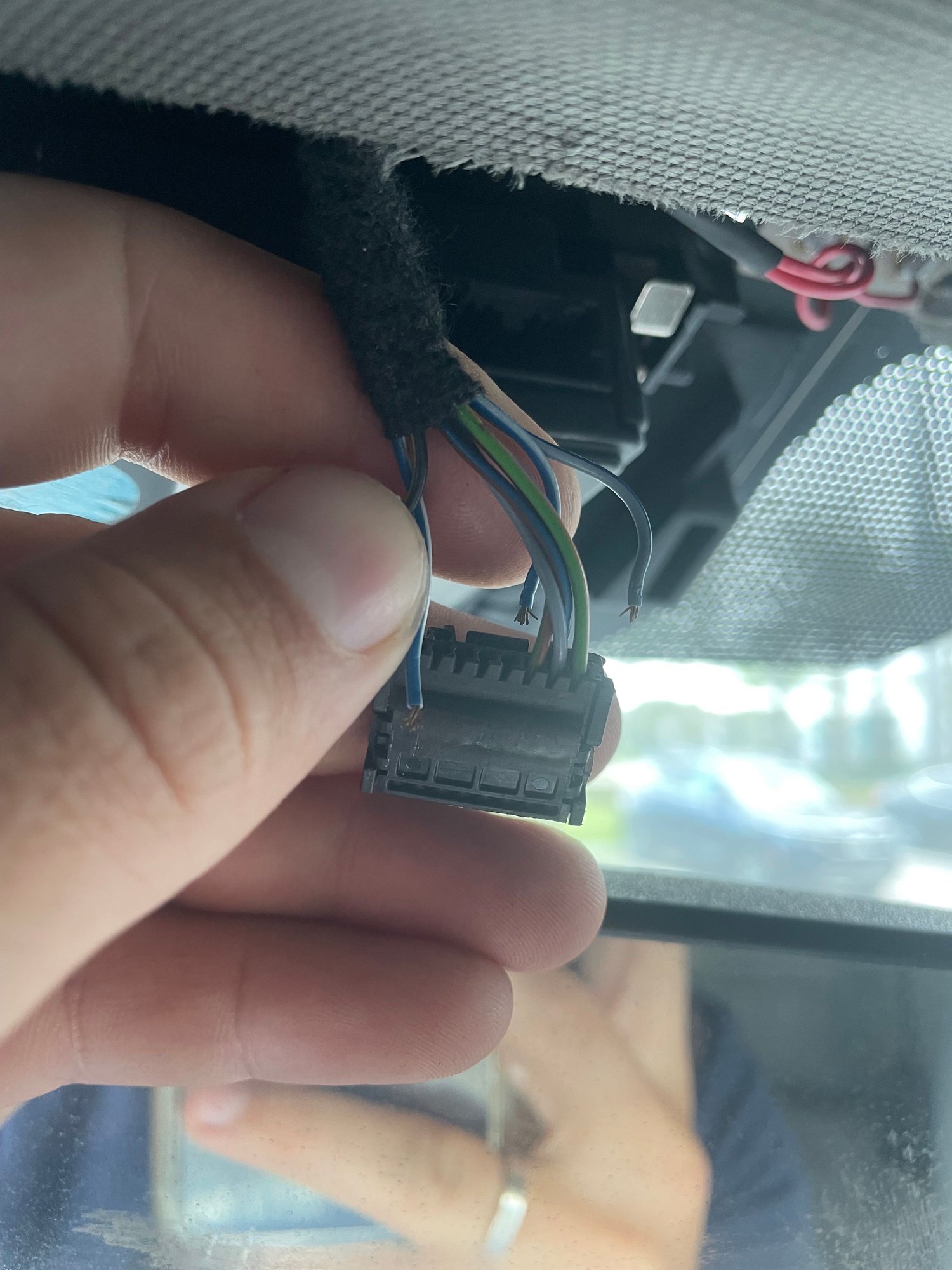

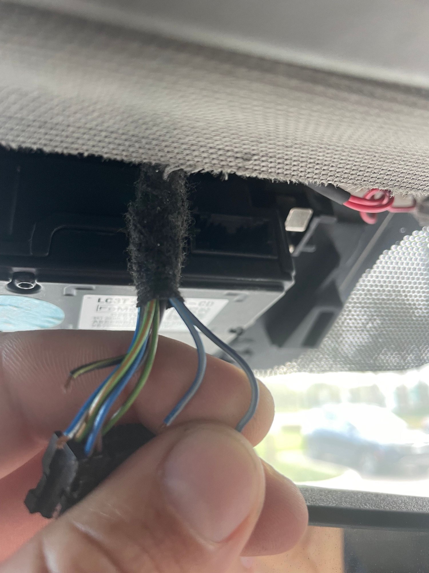

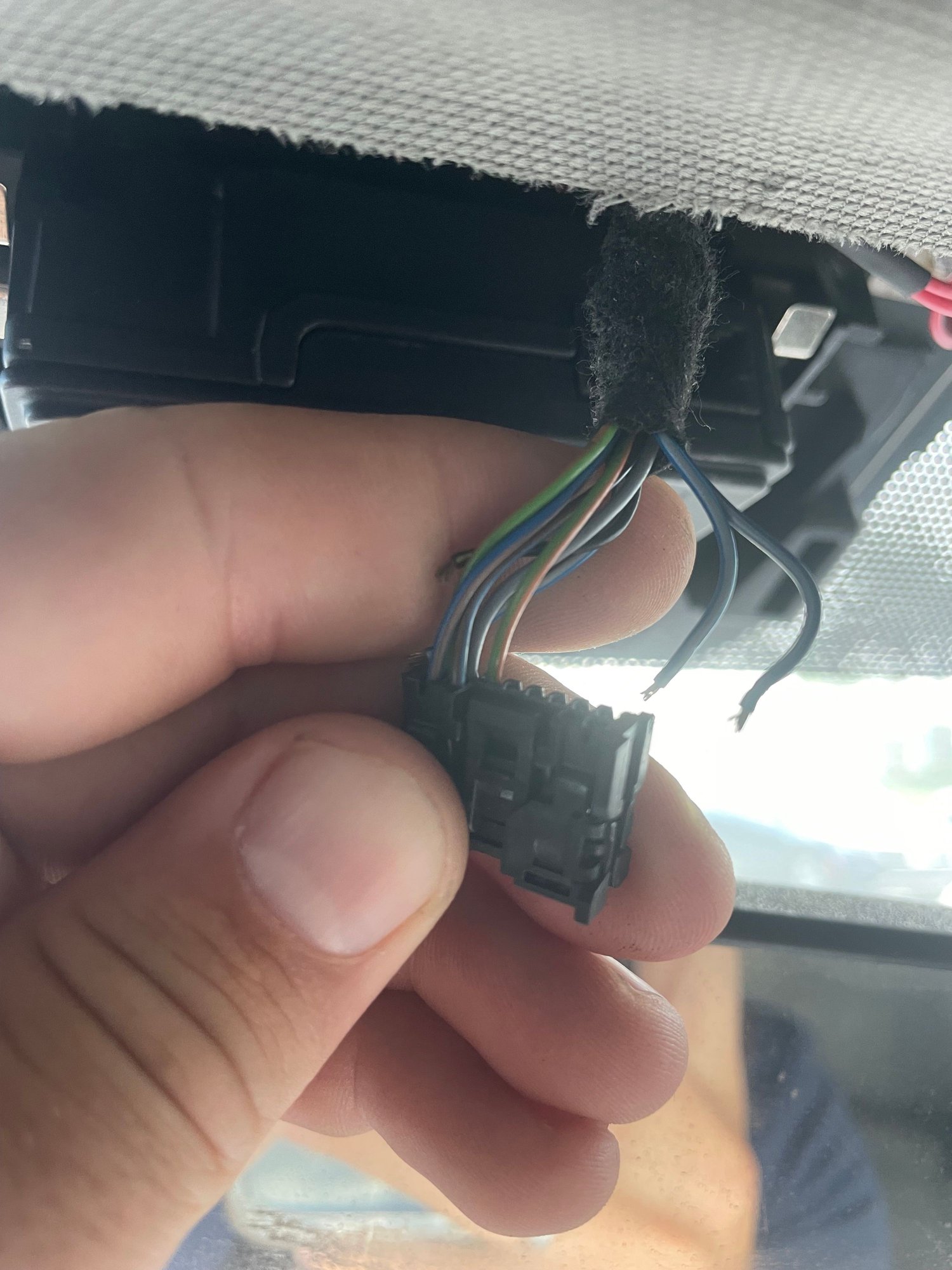

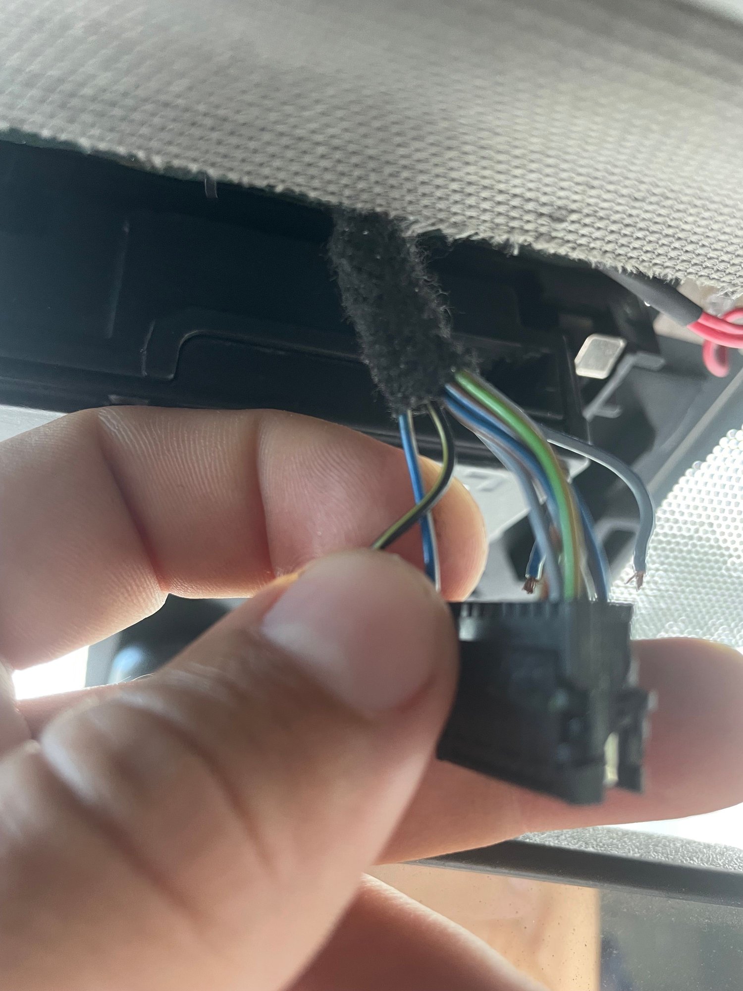

Does anyone by any chance has access to wirting diagrams for 2021 F250? I have an F250 and a tree fell on it. After glass replacement I figured that tree pulled wires from the plug of wiring harness for front collision camera, and i have 2 problems - first theres way more holes in the plug then wires, and second - it pulled 3 wires of the same color .
Is there a chance someone has access to diagrams, or maybe could take a picture of their own harness so i could play with it? it's right under grey cover, no tools required to take the cover off.
Thank you in advance!
blue and white with black and yellow wire
2 blue and white wires
plug back
plug front
Old Feb 18, 2023 | 09:58 AM
Even if you connected all the wires in the correct place, , known as , ADAS ,advanced driver assistance system, will not function correctly ,if at all, until it is recalibrated and that requires special equip and knowledge. A good body shop should be able to assist you with this. Of course a dealership can handle this also.
