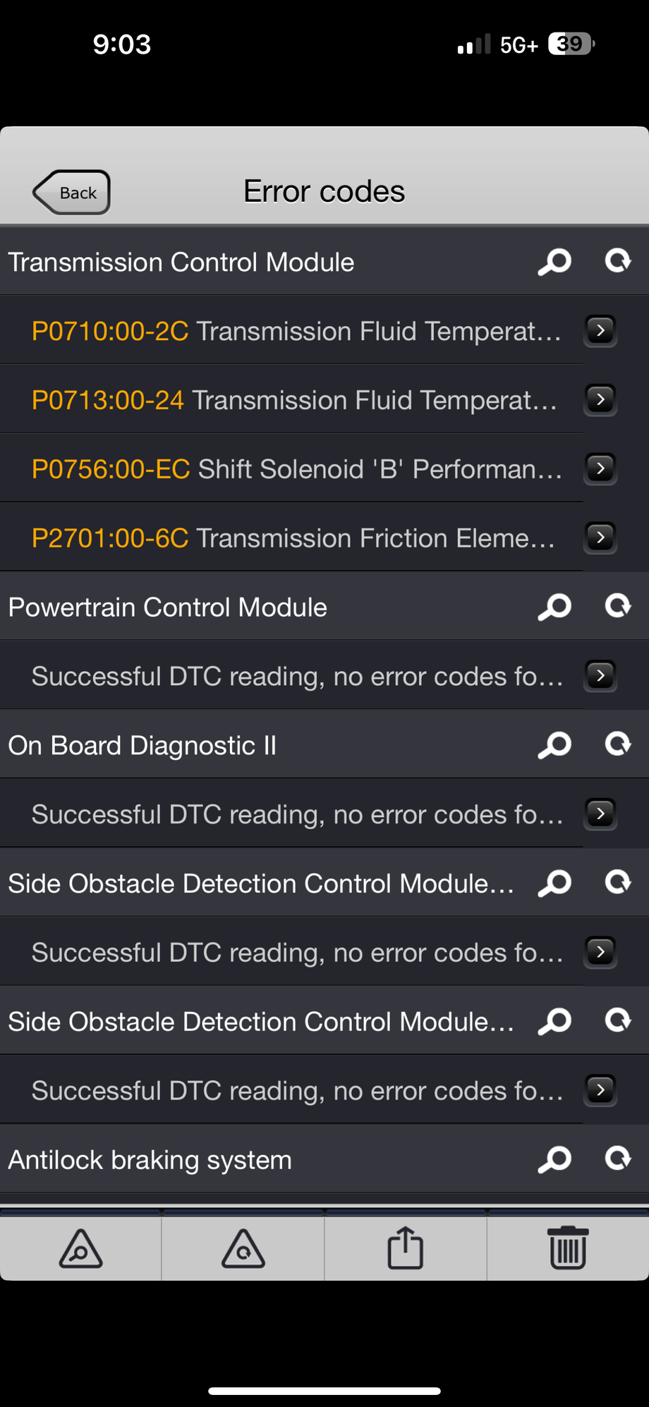

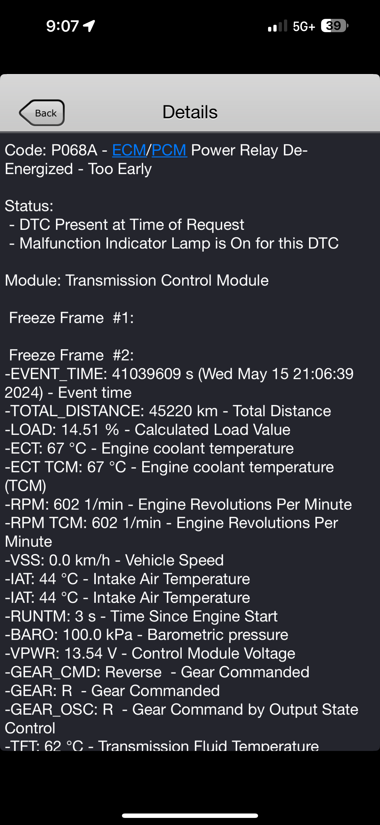

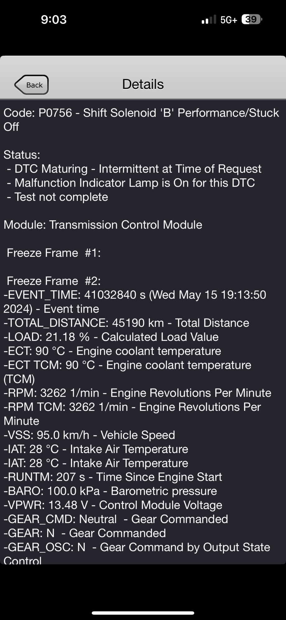

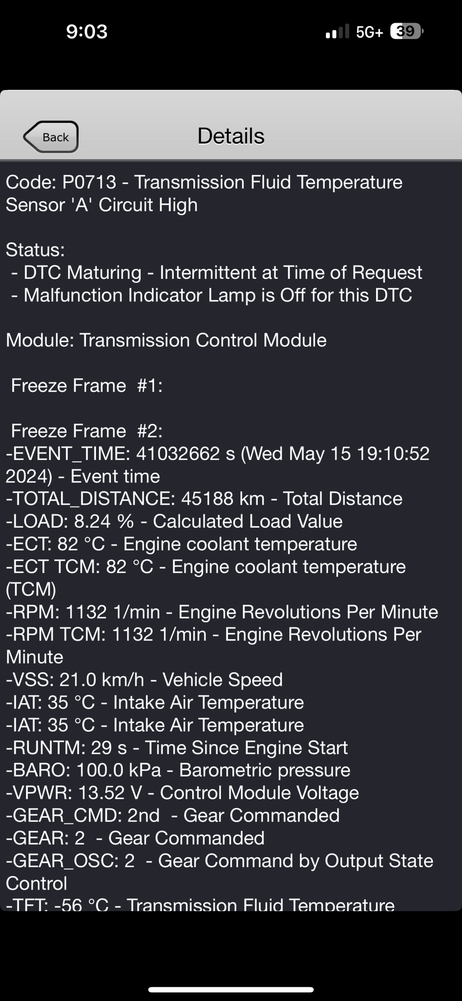

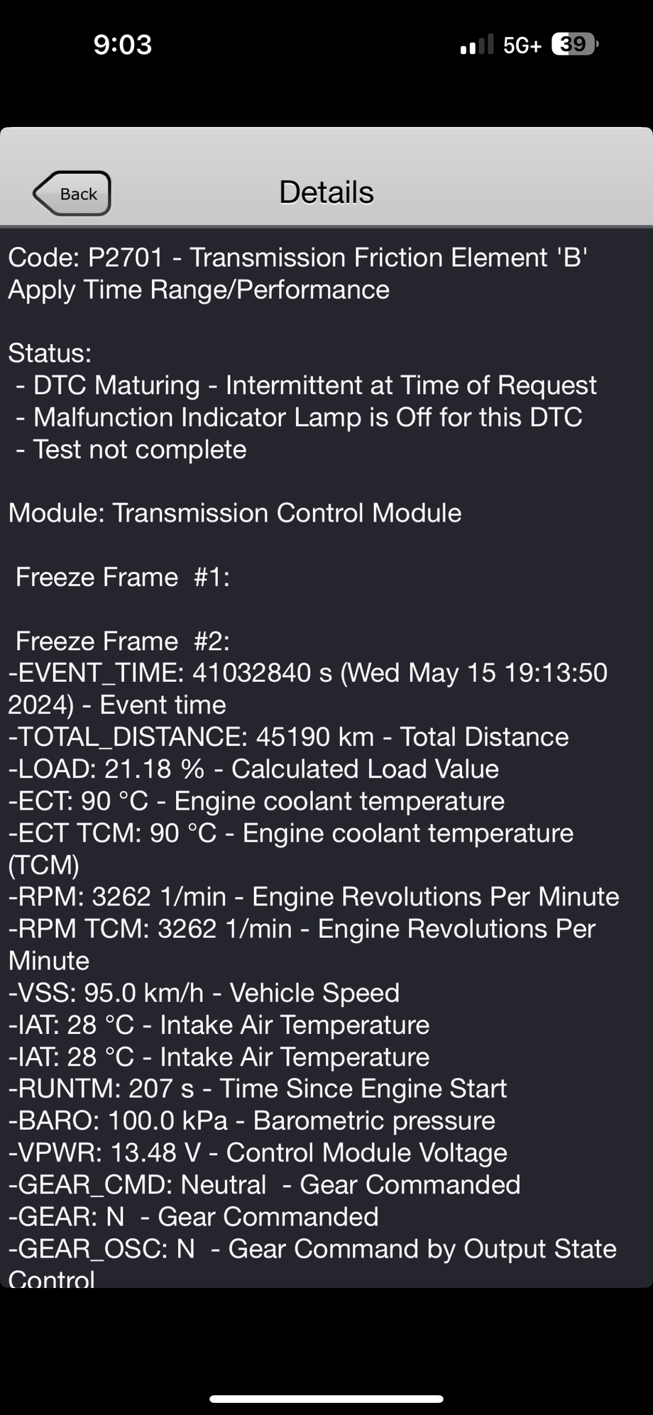

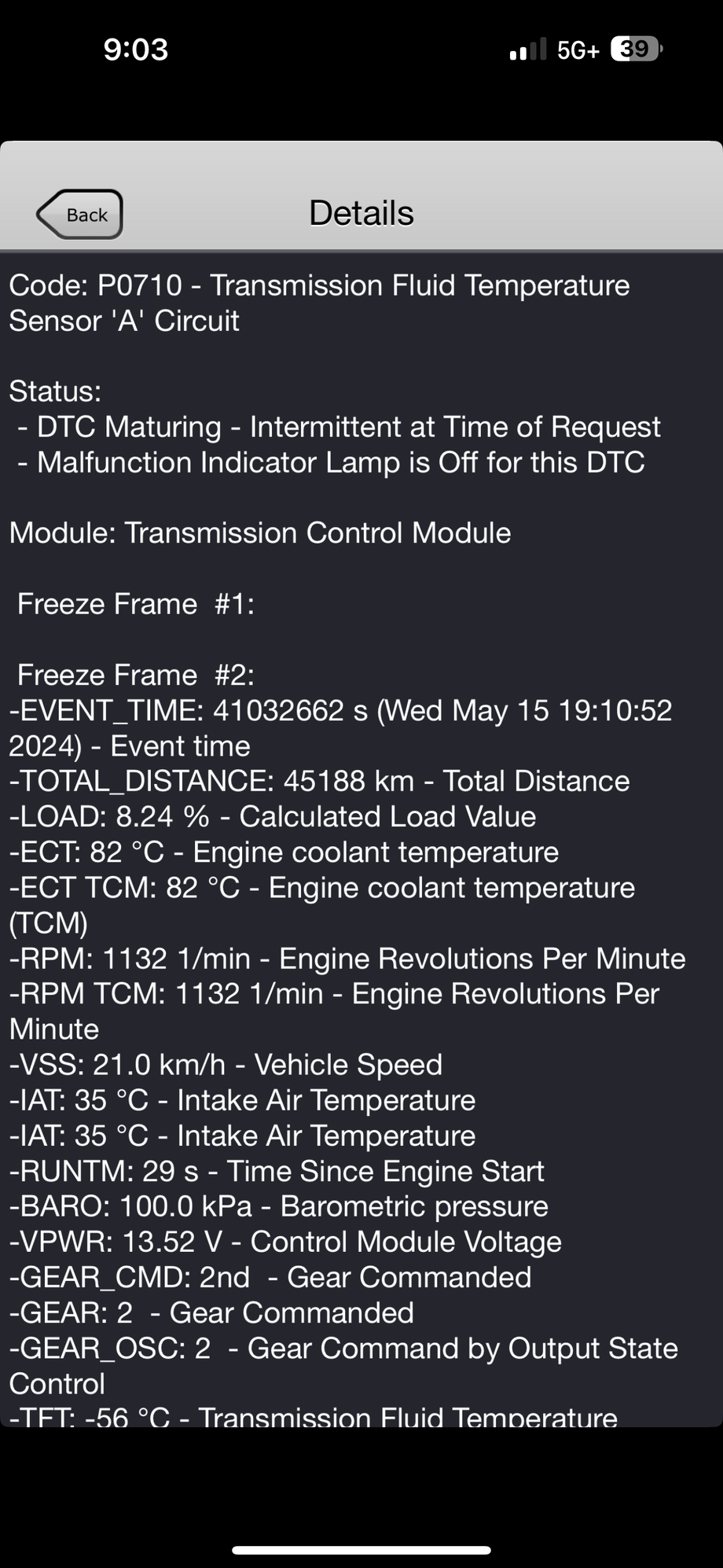

Truck has 25 k miles on it. Long story short went to back up no reverse and only foward gears I have are 3-7. Took to dealer said bad trans put new crate trans in it. Been 60 miles and same **** again. Below in pics are what FORScan picked up as codes. You can delete them and sometimes you have reverse and sometimes not and then you get gears 1-7. Got to be a programming or wiring issue. Would adjusting anything on FORScan make this happen?? Any ideas or suggestions would be great.

find out where your control module is and have it tested or replaced, also test transmission oil for metal debris causing stuck solenoid's because of transmission cooler not being flushed after replacement.
