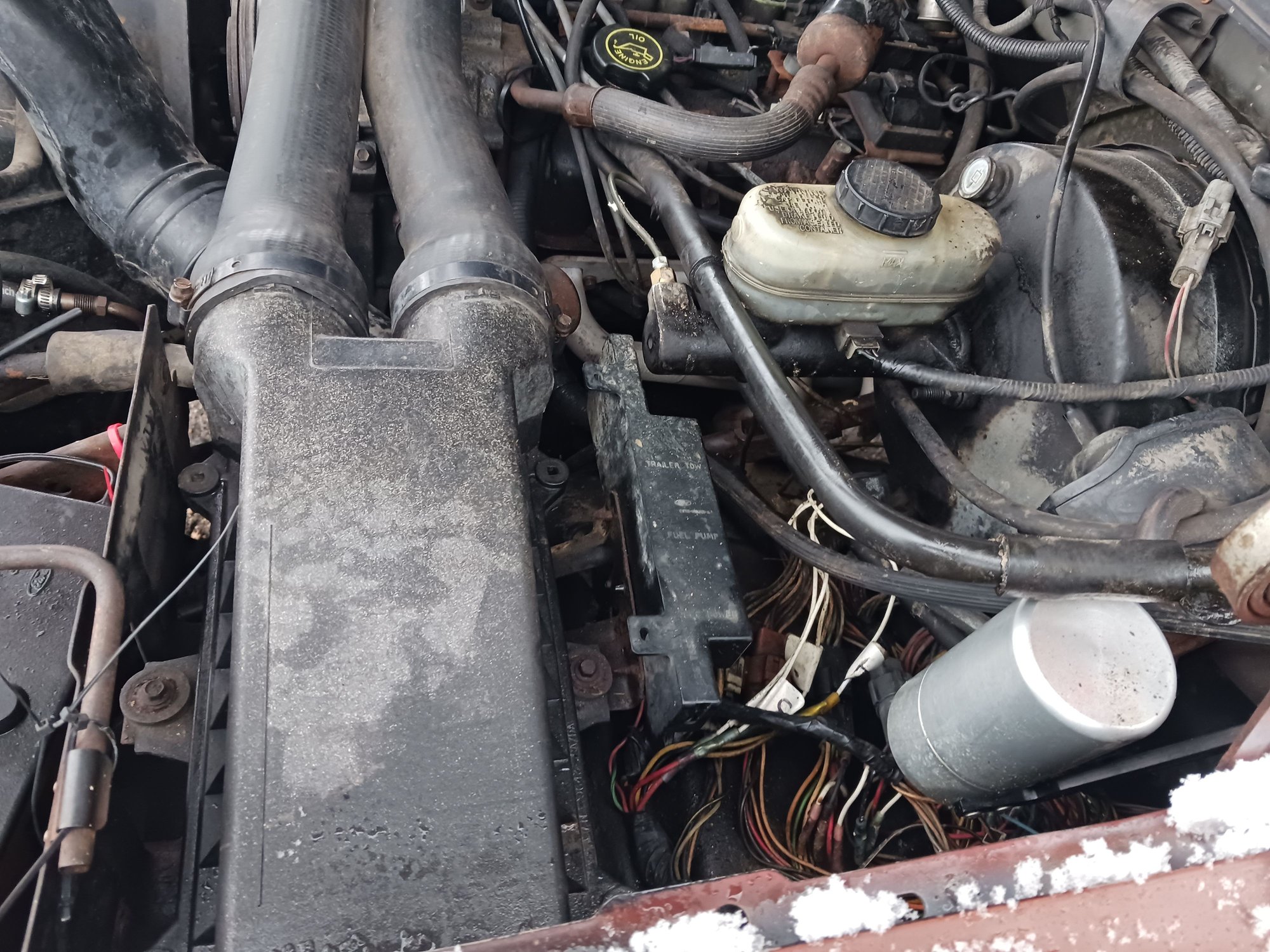

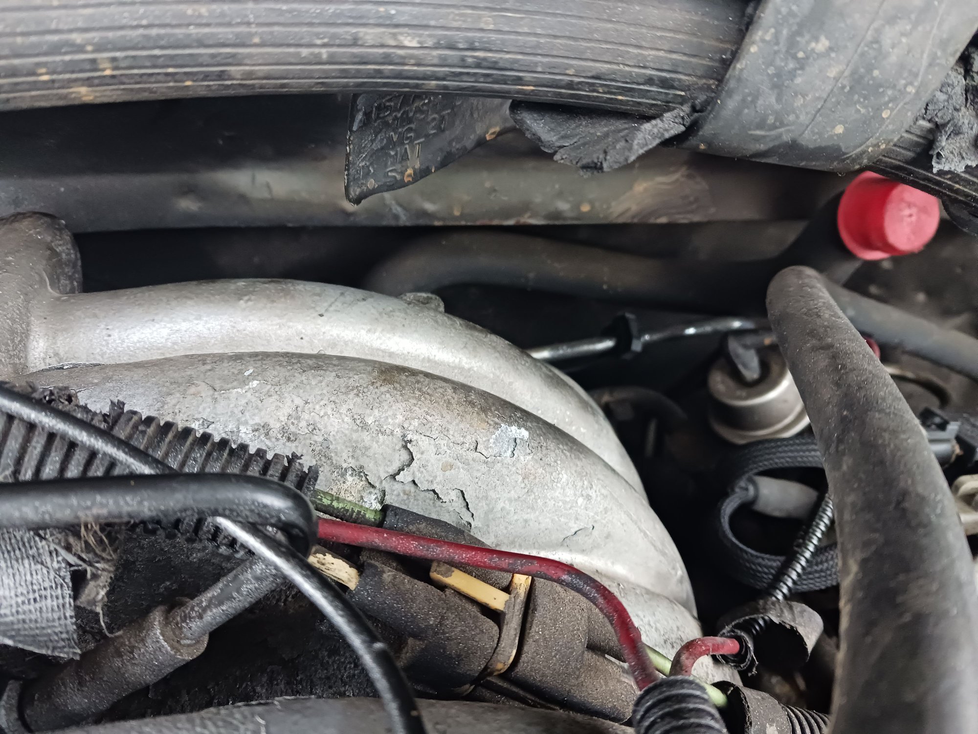

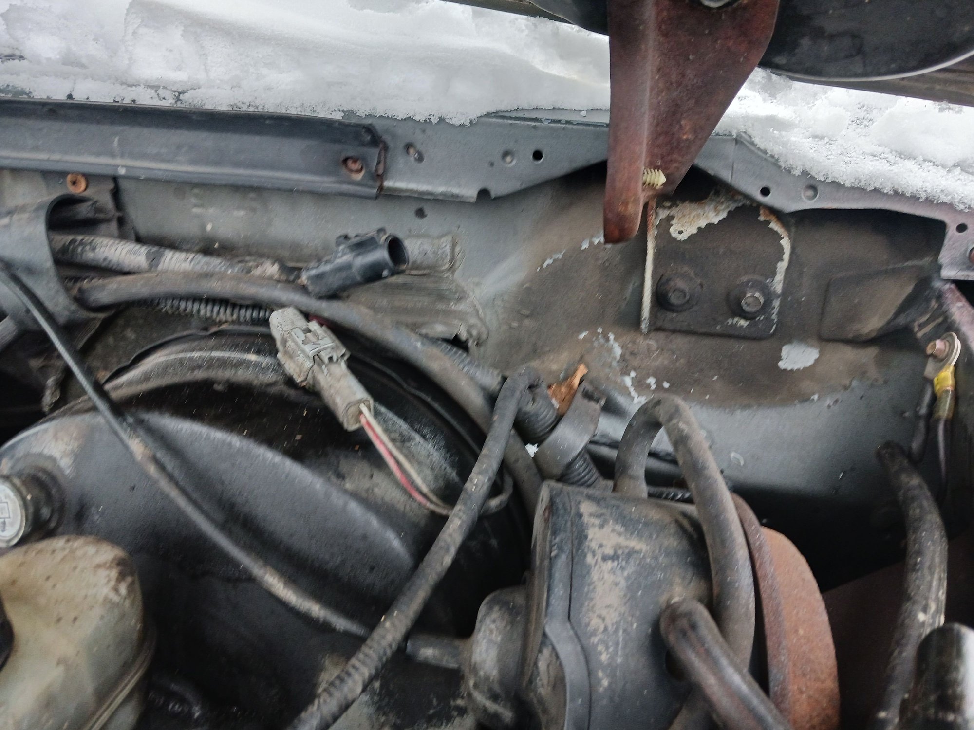

Alright everyone I bought a beater. Never worked on a vehicle this old. I'll be honest no clue as to where to start but I'm not afraid of getting into it I plan on keeping the truck so I'll figure it out but I want to do it right. I'll drop some pics please humor me cause I could use a pick me up but atleast be informative please I wanna see this beast come back to life

And here I thought Dr. Frankenstein was only a movie character. !
Check the fluid levels ,make sure they are good, get a new battery ,clean the cable connections and turn the key to start and see if it at least will turn over..
We have no idea of what is in the fuel tank so that needs to be checked and some fresh fuel put in.
We can tell it was stored outside ,but where and for how long? Mice have a way of building nests in the air intake system. Make sure that is clean.
Don't know if it was driven to it's resting place or towed there.
