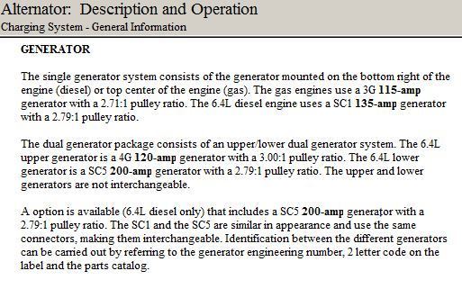

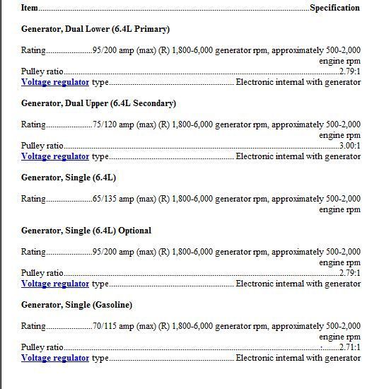

Ok guys just getting around to replace both alternators but finding that the 120 amp alternator part number 7C3Z-10346-CERM is unavailable ,the 200 amp 7C3Z-10346-EA is available all day long so I ordered it.
My question is there another alternator 120 amp or higher amp rated alternator I can substitute for the dual configuration?

Check WAI GLOBAL 8522N at RockAuto and use 292739446259187330 at checkout, it's 120amp made for dual alt system.
Alternators don't break easily curious why you need to change your alternators in the first place. If you run custom power hungry system you "upgrade" to high amp ones, not stock. Better yet, you have that money to spend you install a solar system, dirt cheap these days.
