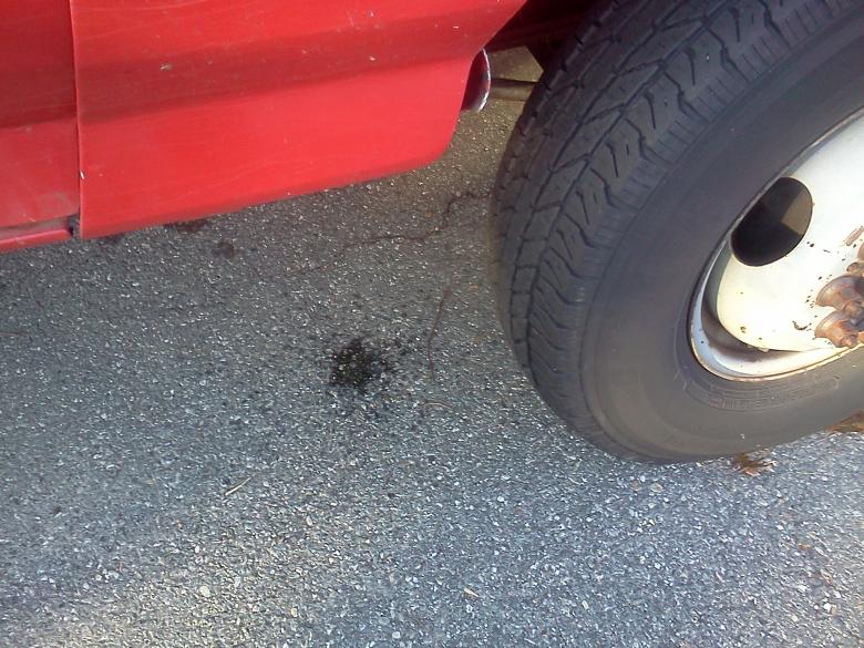

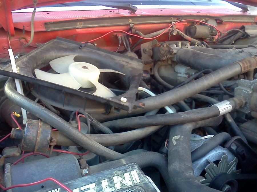

I looked at it today and still cant figure out which one is leaking. Theres so many damn hoses. I really dont want to pay for a leak down test.

No smell in the cab but it does smell under the hood and the temperature gauge isnt working but that wasnt working before I noticed the leak. I dont have foggy windows like the heater core went and the heat is still working.
If you look at the puddle its real small drip but I'm worried about it busting in the middle of a snowstorm.

the hose coming out of your water pump and across the top of the alternator appears to be the hot water feed into the heater core...the return from the heater core would be worth a look.What is that fan thing with the white blade?...Never saw anything like that.
Old Jan 15, 2012 | 10:58 PM
sectlandscaping's Avatar
Joined: Oct 2011
Posts: 35
I think the previous owner put the fan there to keep the hydraulic lines cool.
