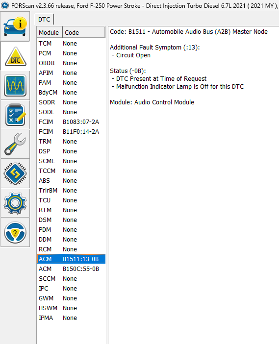

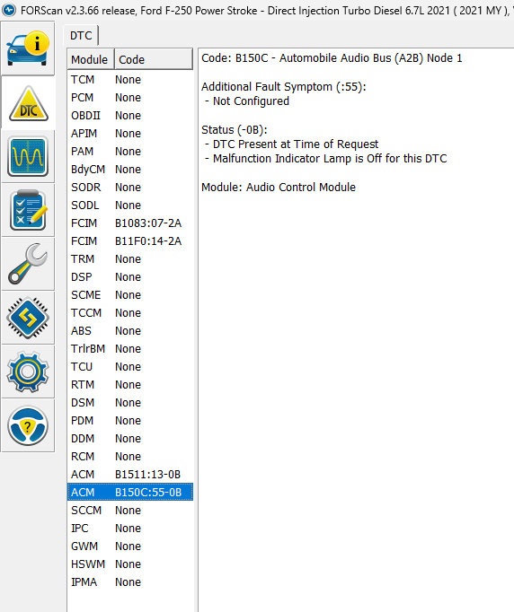

heres whats its showing

Your truck is too new, my alldata software supports any car up to 2007 with full pinpoint tests and what to do based on a specific DTC.
If your radio and speakers are working fine, you shouldn't act on anything. But since you have Forscan you can erase the DTCs and see if they come right back. You can also reset ACM module and Instrument Panel Cluster (IPC) Module.

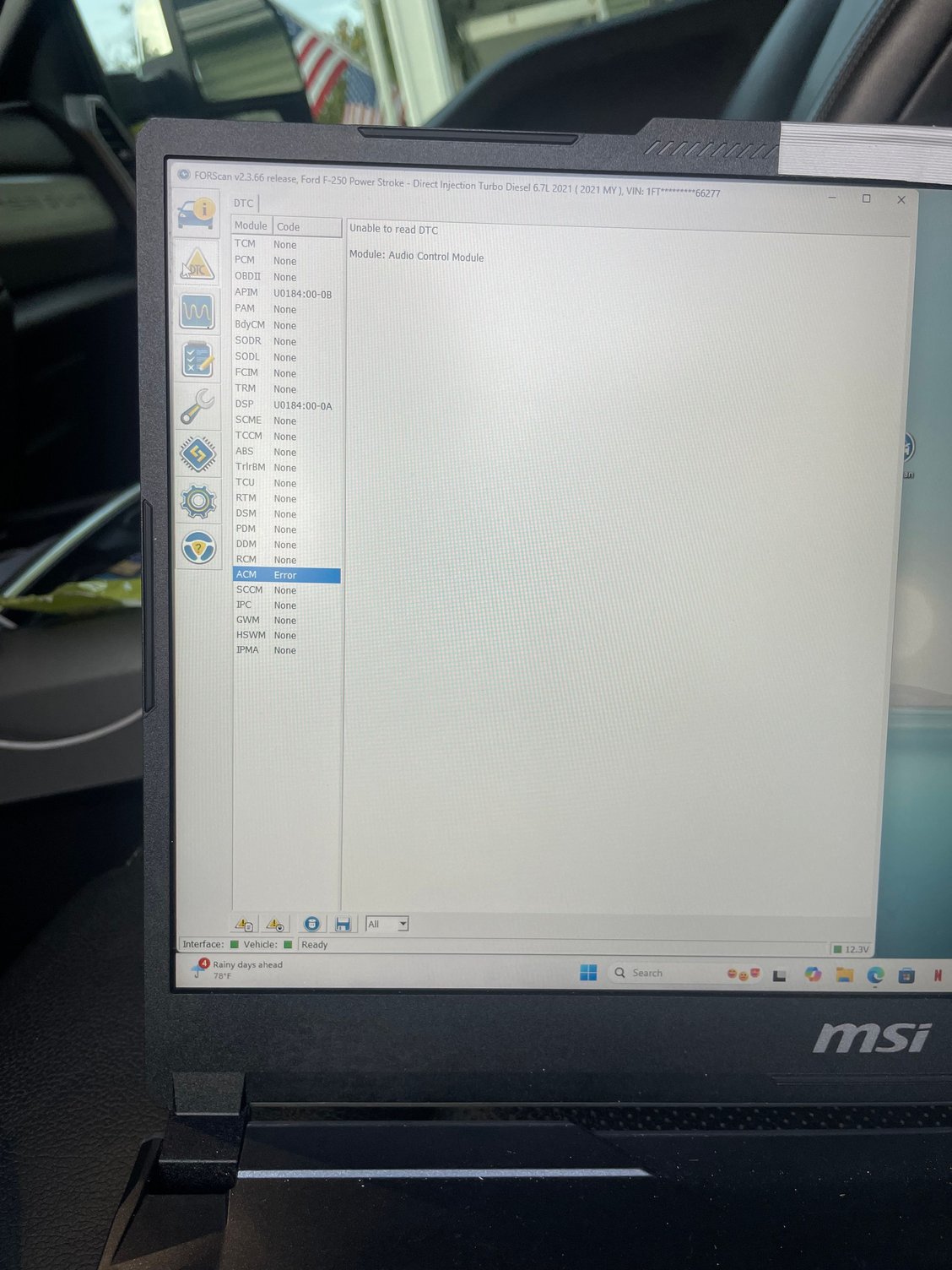

Thank you! It was working for about a month & now it seems to be completely dead. FORSCAN is giving me an error now & saying it’s “unable to read DTC”
