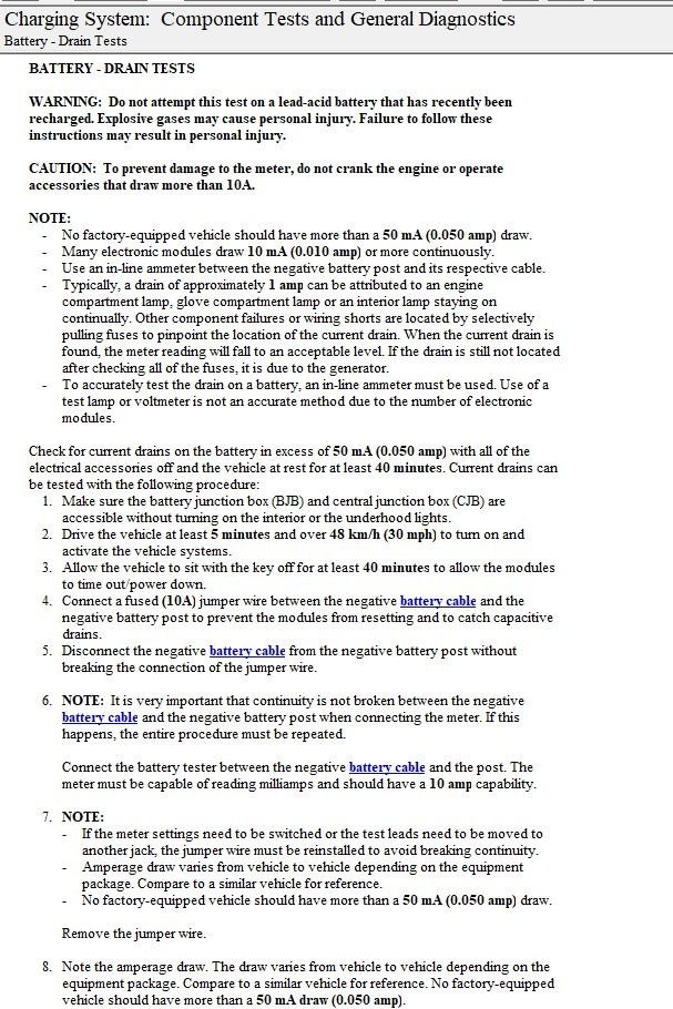

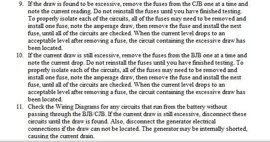

Above battery drain test is for 2007 F250 Super Duty 5.4L from my alldata software, I don't have any for 2011.

There is a fault in the instructions.
Pulling fuses allows the faulty module to reset and when you reinstall the fuse ,no fault will show up..
The better way to find the problem is to measure the voltage drop across each fuse.
This requires a little knowledge of voltage drop testing. There are several videos to explain the procedure.
