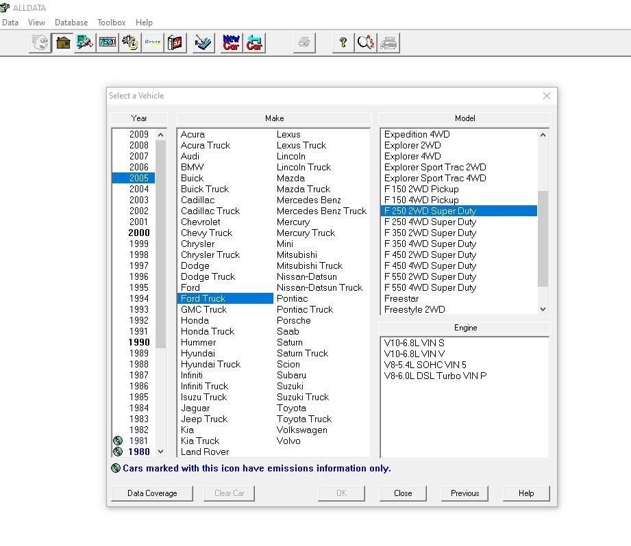

Question # 1 I asked previously remains unanswered. Check above the "OK" button is not clickable, can't continue.
The blend door should be integrated into the heater box as one whole unit, not 100% sure until I can't click the "ok" button to pull diagrams.

I am sorry but you have me completely confused--I do not see any "signature" or anything below each of your posts so not sure what you mean there--My truck is 2005/F250 4WD auto with 6.0 powerstroke--I see some other posts about having to make sure the actuator goes in correct way--my new on just slipped right in very easily right out of the box--so if it is keyed I would think the blend door was in the correct spot.The truck is in shop with a water leak-hose I hope -so I dont have access to 8th VIN digit right now-sorry
