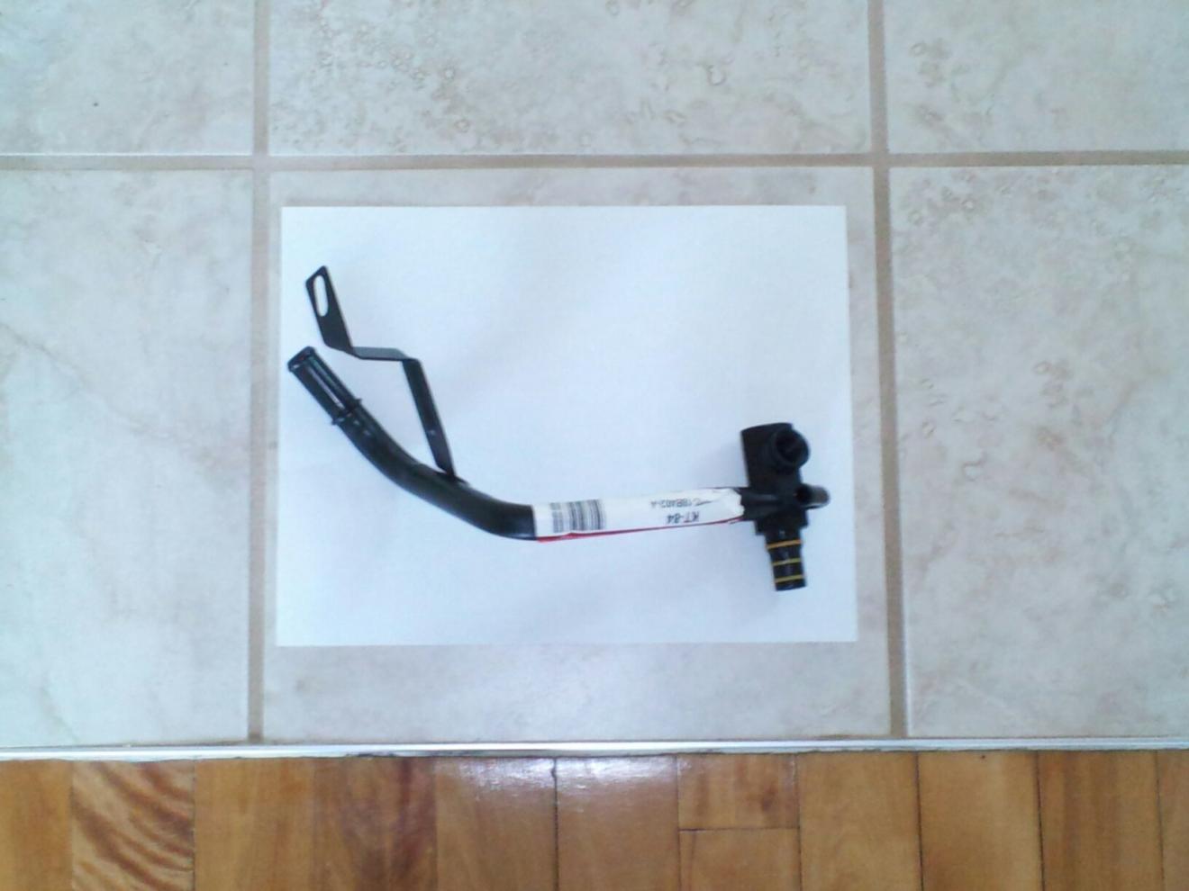

Well Hanky, here's that $141.76 part from Motorcraft. Found it online for $87.02 including shipping. Amazing! There's nothing to it. I was told that its a two piece tube, but my informant was wrong. Scary! He's a Certified Ford Tech too. Anyways, it appears to just slip into the opening on the intake manifold. There are no threads, only 3 "o" rings. So I'm assuming that the bracket is suppose to keep this thing in place. I don't know, but I will know better tomorrow when I install it.
