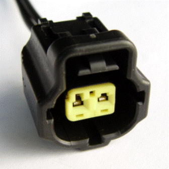

Sure its not Blue/Gray and Green/White?
Here's the repair connector/pigtail image for the cylinder head temp sensor...
We finally found the senor hidden on the driver side head. See picture.
