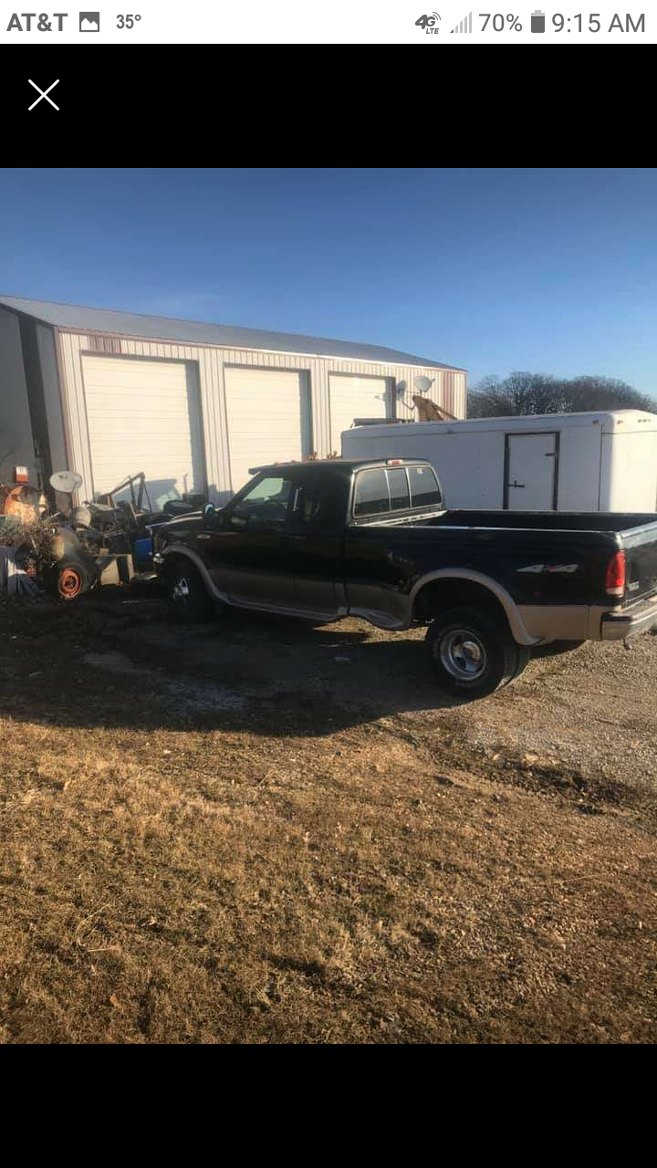

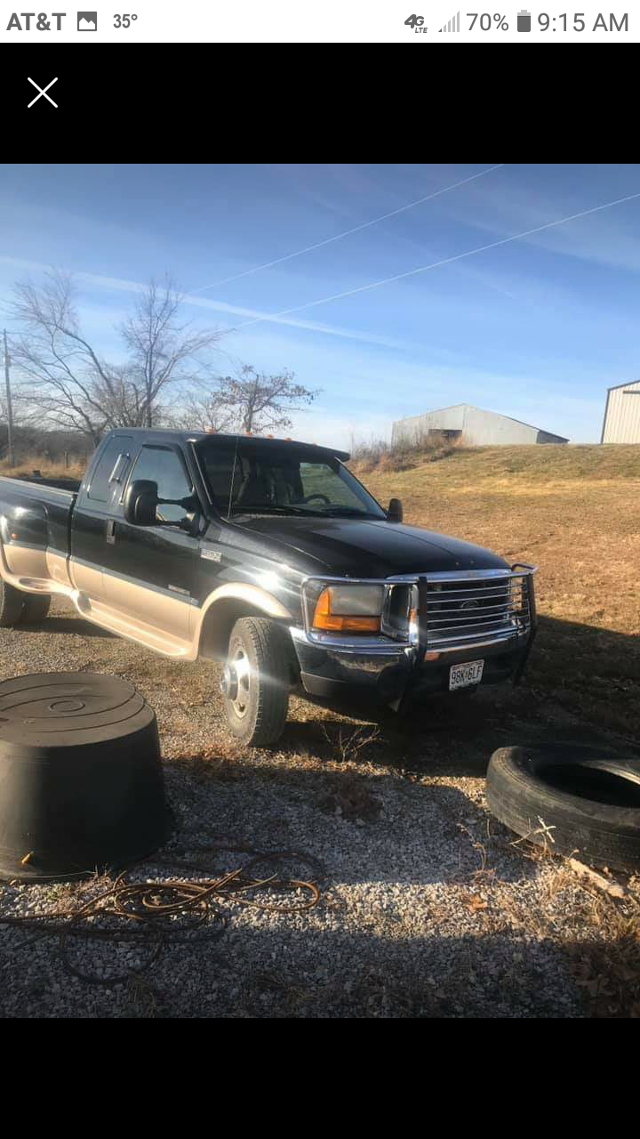

Update. They sold Red before I could get her. I was in the dealership Sat and they sold it Monday morning. So I continued my search and found this one from a private seller. 1999 ext cab F350 DRW 4X4 7.3 powerstroke.
More miles and not as pretty as red, but saved almost $4500 and she started with 9 degree weather today here in Missouri. Ran strong with a relatively new jasper tranny and no blowby. Underneath looked good with relatively Very little rust and no leaks.
Only need to lose the KN air filter and do the oil change. Plan on buying arch oil fuel and oil additive with Rotella 15w40 oil.
Here's some pics of the new addition:
Thanks again guys for the help. This is my first diesel so I'm sure I'll have more questions down the road.
