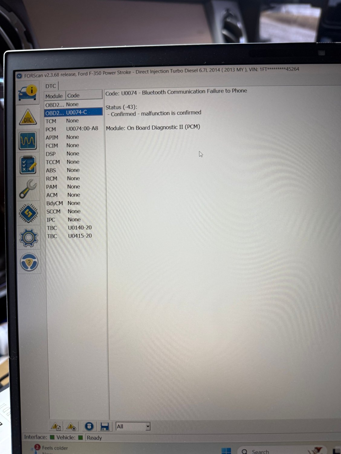

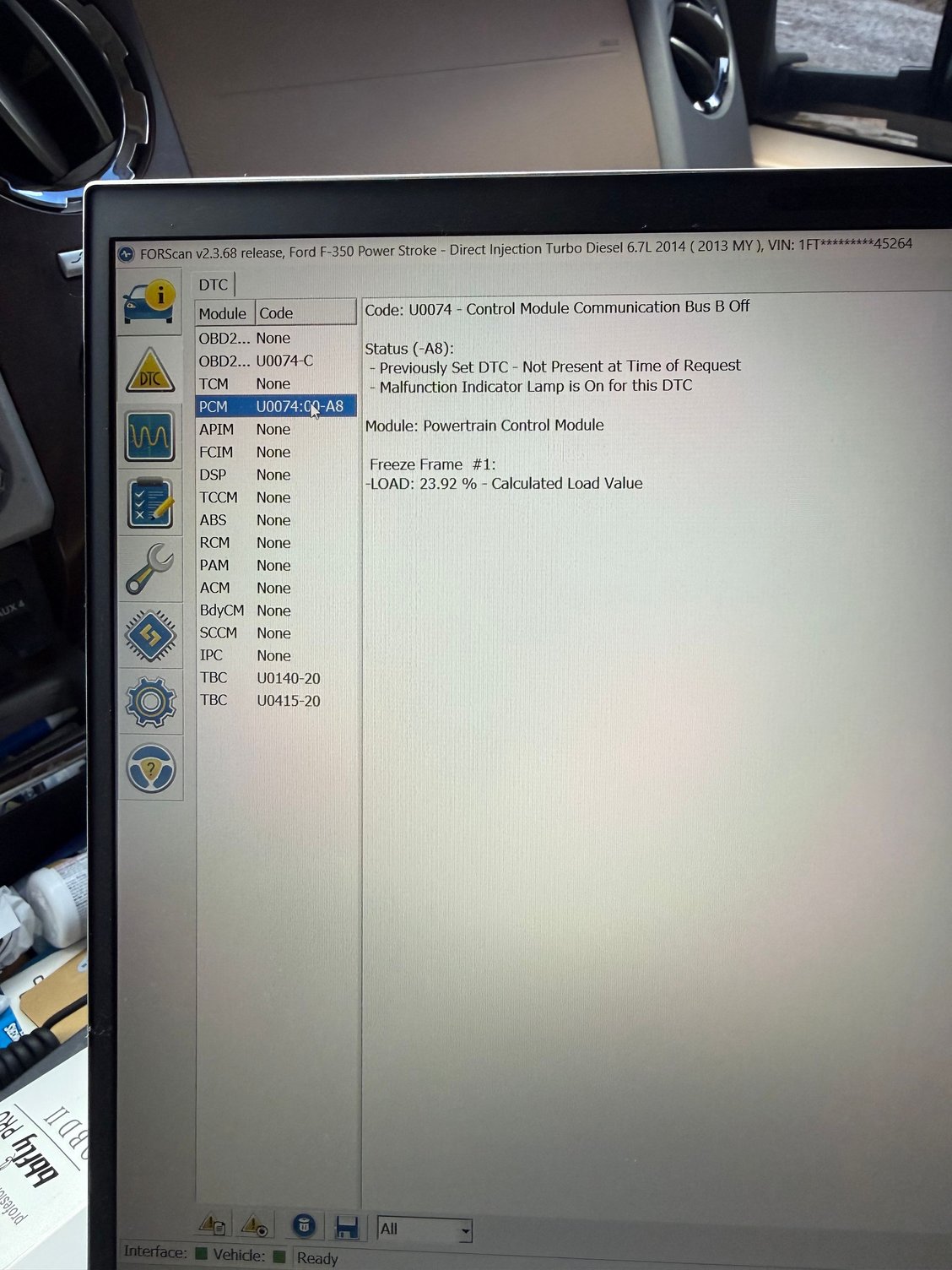

Old Feb 23, 2026 | 04:29 PM
MarkCooper's Avatar
Joined: Jan 2026
Default Update
Sorry for the delay. I was able to finally get the U0074 code and hook up the ForScan app. So apparently the vibration / brake pedal experience are a coincidence. ForScan actually gave me these details in the attachments. Turns out that apparently my wife's phone was causing the error. As soon as I removed her phone as a Bluetooth option started the truck the light went off. Brakes are still pulsating. Hope to check the rotors this weekend since it is the first weekend free in months!
