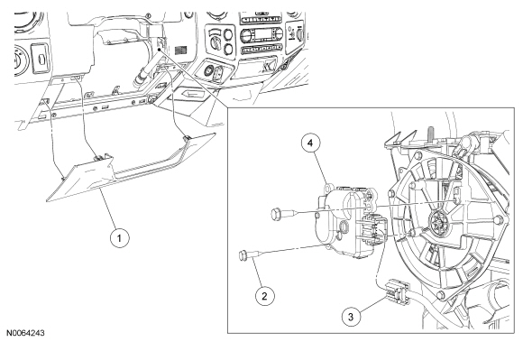

Mode Door Actuator — Defrost/Panel/Floor Door
Item Description 1 - Lower steering column opening trim panel. 2 - Defrost/panel/floor mode door actuator screw (2 required). 3 - Defrost/panel/floor mode door actuator electrical connector. 4 - Defrost/panel/floor mode door actuator.Removal and Installation
  1. Remove the lower steering column opening trim panel.
  1. Remove the 3 defrost/panel/floor mode door actuator screws.
  1. Disconnect the defrost/panel/floor mode door actuator electrical connector.
  1. Remove the defrost/panel/floor mode door actuator.
  1. To install, reverse the removal procedure.

Thank you! I spent all night looking for a diagram but the explanation you attached explained the location perfectly! Thank you so much!
