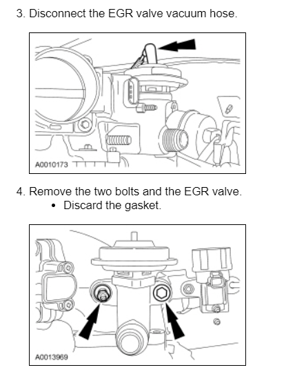

Here is where the EGR valve is located on the 5.4

Yeah mine doesn’t look like that..there is no assembly with that valve in that part of the engine bay, more is there anything coming out of the manifold...maybe I’ll take a pic

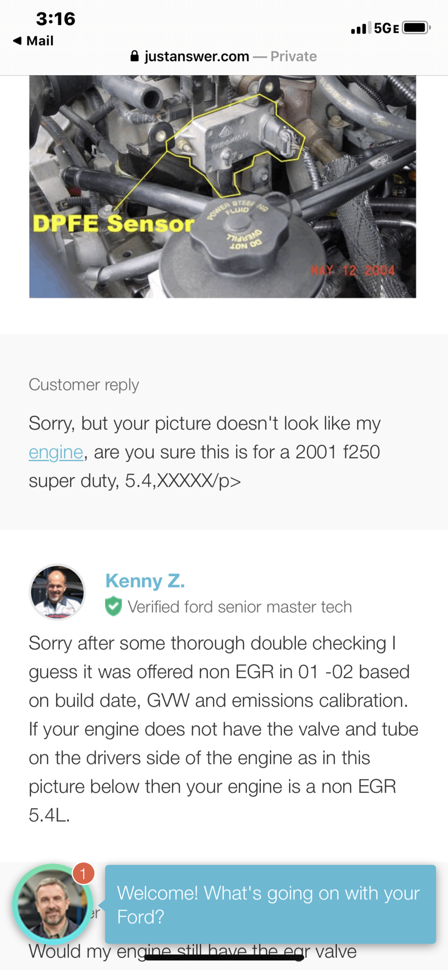

When getting a quote for the replacement motor, their computer asks with or without EGR....I’ve been told that some of these motors have like an internal EGR...because my mechanic who would be installing said motor immediately said no EGR...there is nothing that is covered up on the exhaust manifold to suggest that the system which I’ve seen (which looks like a steel pipe with a valve on top) ever existed...
