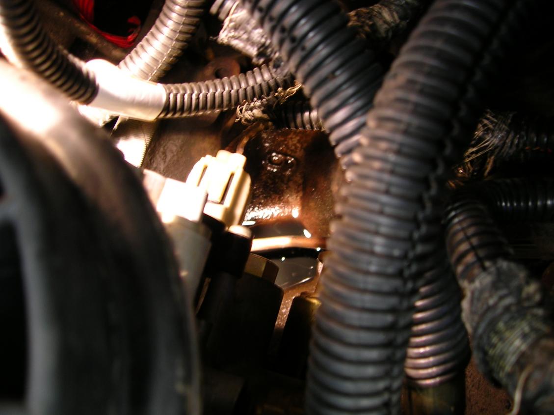

If the oil is more forward in the valley and puddled under the the fuel/water separator could be the HPOP (high pressure oil pump)
If so, look for HPOP high pressure line/s for the orings leaking or the brass plug underneath (the white connector in the image) . A common leak there as well as the lines. Since oil doesn't run up hill, if its wet towards the front and under the HPOP chances are its not a pedestal leak..

df and Hay,
Thank you. The oil is more to the rear almost right under the turbo. I'll try looking more closely. Thanks for the leads!
