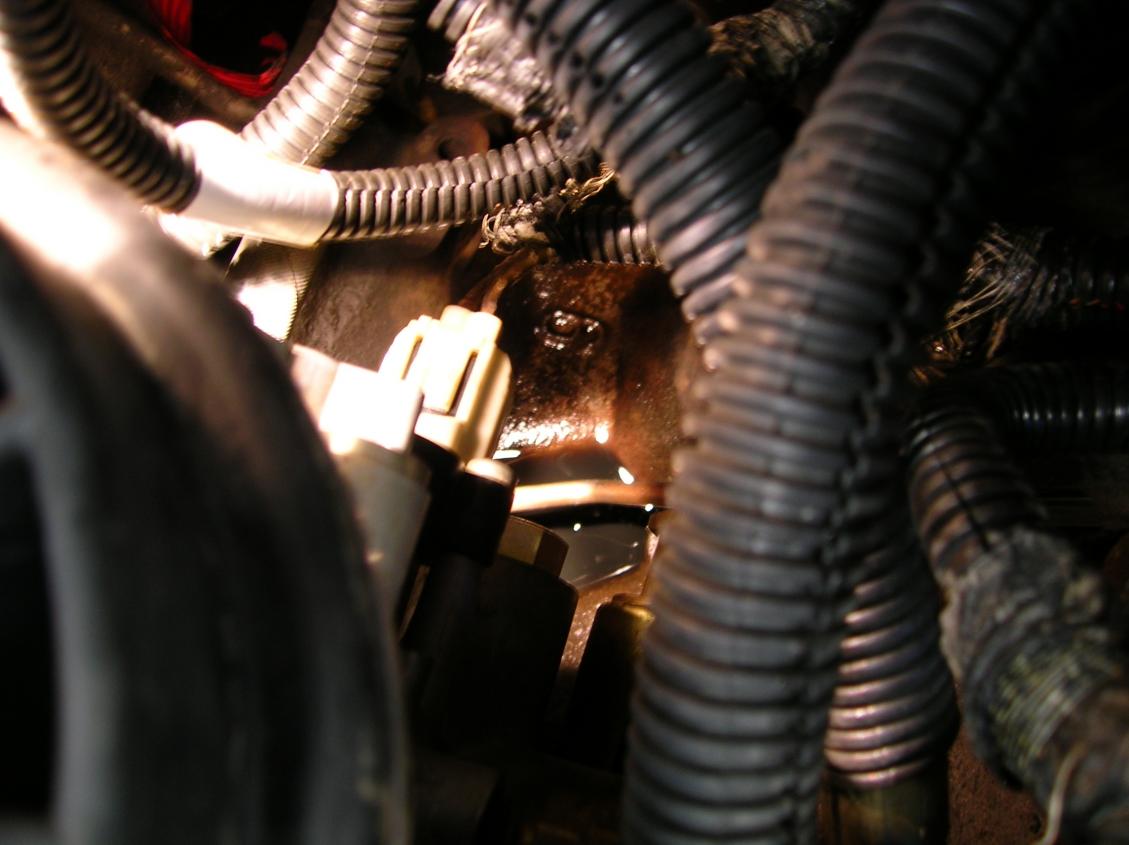

Depends on how far 'forward' the leak is,, Line, or fitting orings? Both? There's also a plug that like to leak on the HPOP, down low/rear under the fuel heater. If the valley looks dry under the HPOP then the ped may have a leak. Pressure wash/steam the valley and run the engine to pinpoint the leak.. Here's a pic of one I did a while back. You can see the oil puddle, and the plug down below the FH..

washed and degreased valley. looks like possibly hpop gasket. oil is all up front in valley right under fuel bowl.
