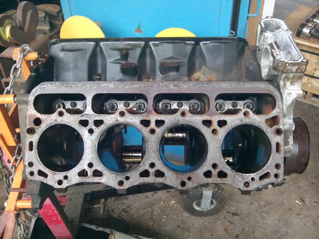

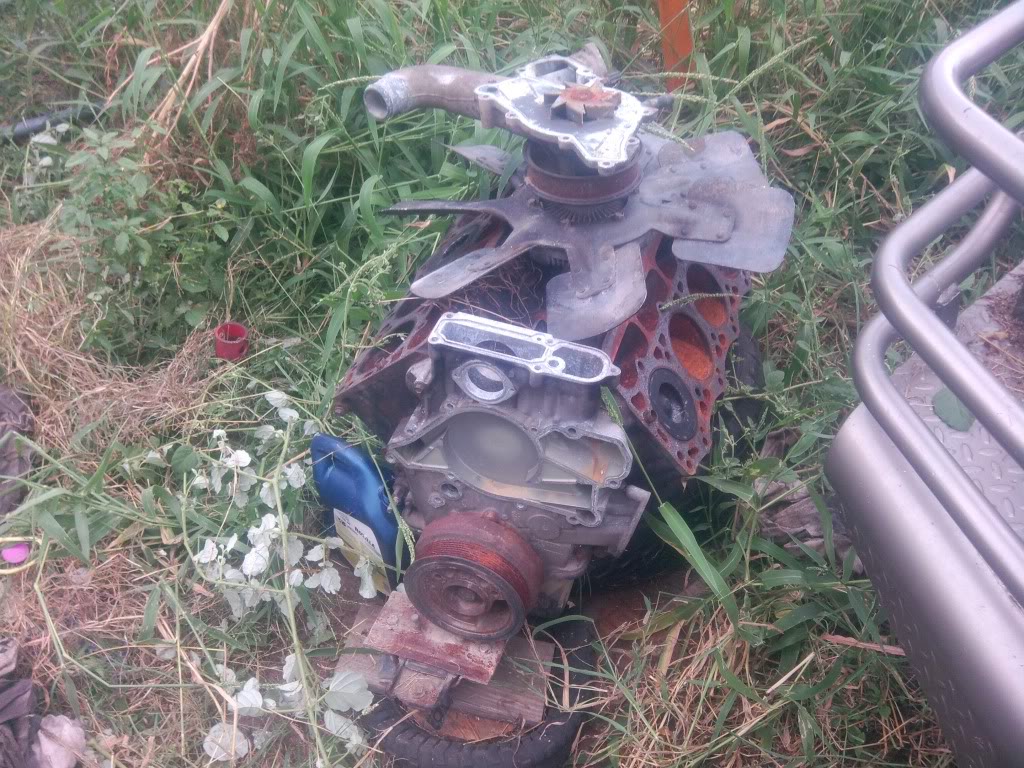

Less than a month ago I broke a '02 7.3 block free after it had been sitting outside with the heads off for 6 months... with less than a quart of fresh super tech wall mart trash atf...
Let it sit in the cylinders for about 10-15 minutes and put a socket on the damper bolt.
Gently rocked it back and forth and it was spinning in no time.

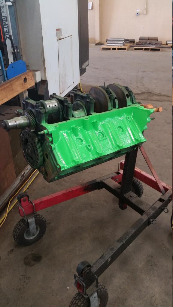

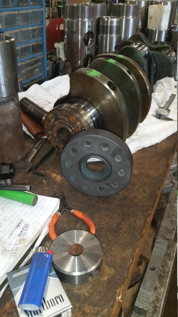

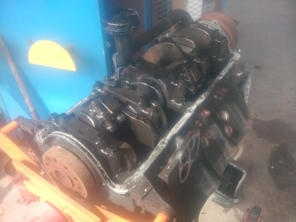

The cause of all the trouble... (among another very controversial cause)
Phosphate treated crankshaft-flywheel adapter/spacer. Probably the only one on Earth like it!

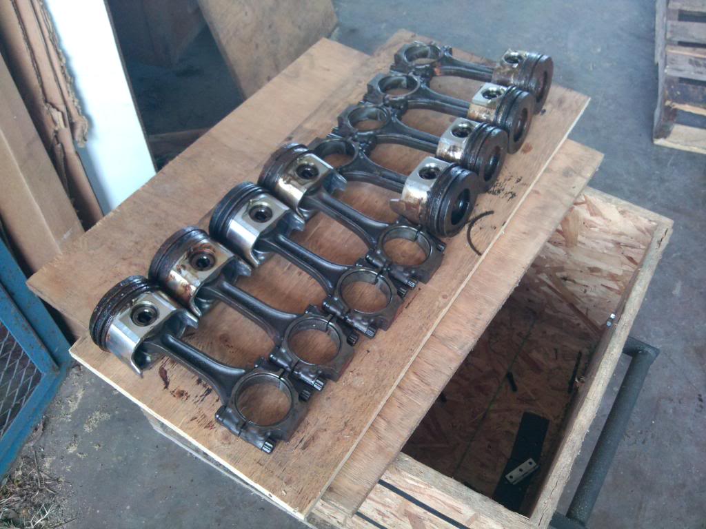

After 260 some odd thousand miles of raw unfettered abuse...
This is the most pronounced wear on a journal set on the crank.
It measured less than .001"
So split in half it was less than .0005" wear per side. Which should hold tolerance after a polish job on stock mains and rod bearings. (The size fellas... not the factory original stock bearings I just took out... sheeeesh!)

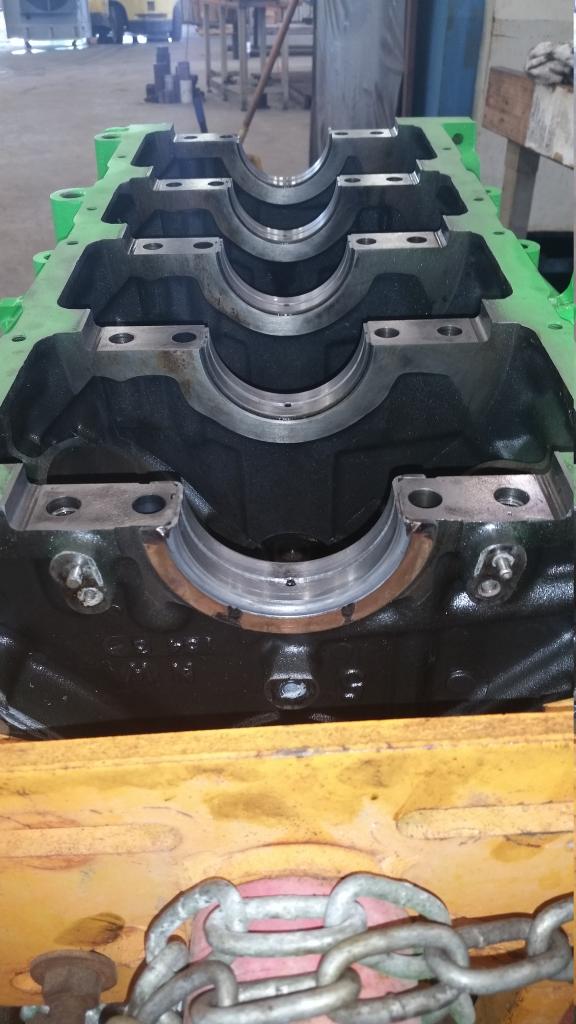

Just about ready to go visit the block surgeon...

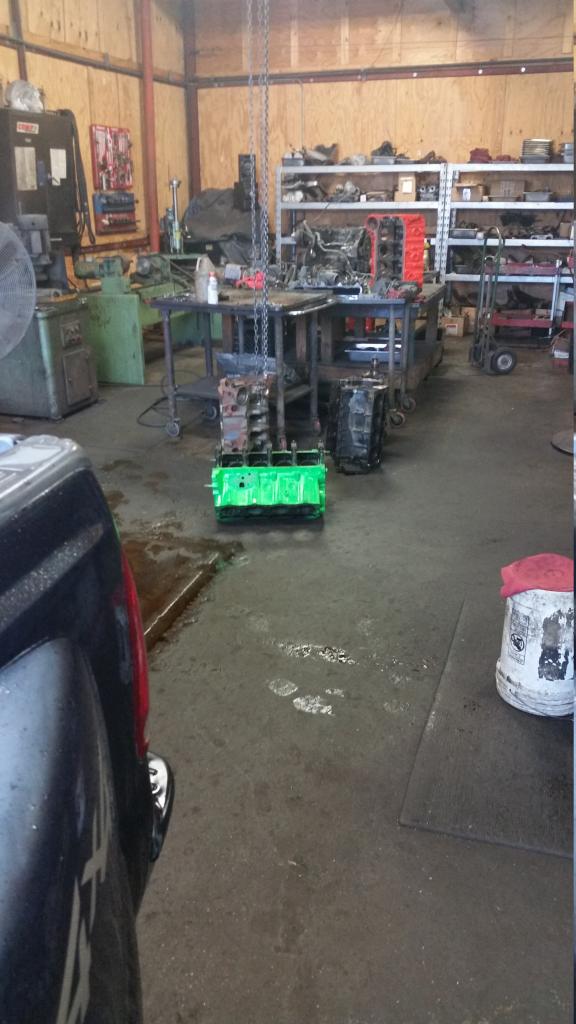

And yes I do realize the irony of the block being outsourced for cam/crank polish and cylinder boring while there is a fully tooled cnc machine shop in the background in most of these pictures.. i would just rather pay someone who does that specifically for a living than build an angle plate for my bridgeport. It is an entire pain in the excretion point...

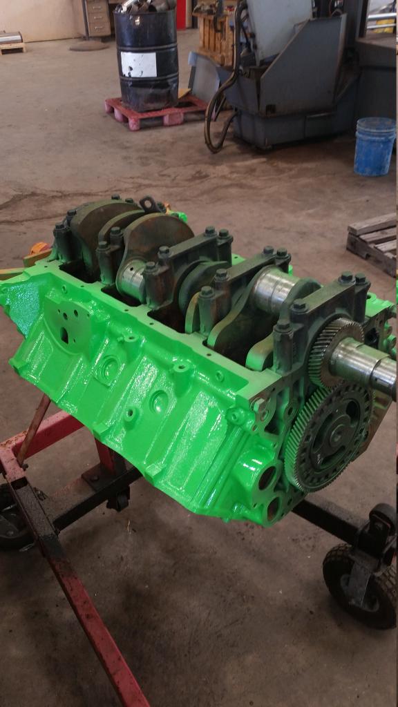

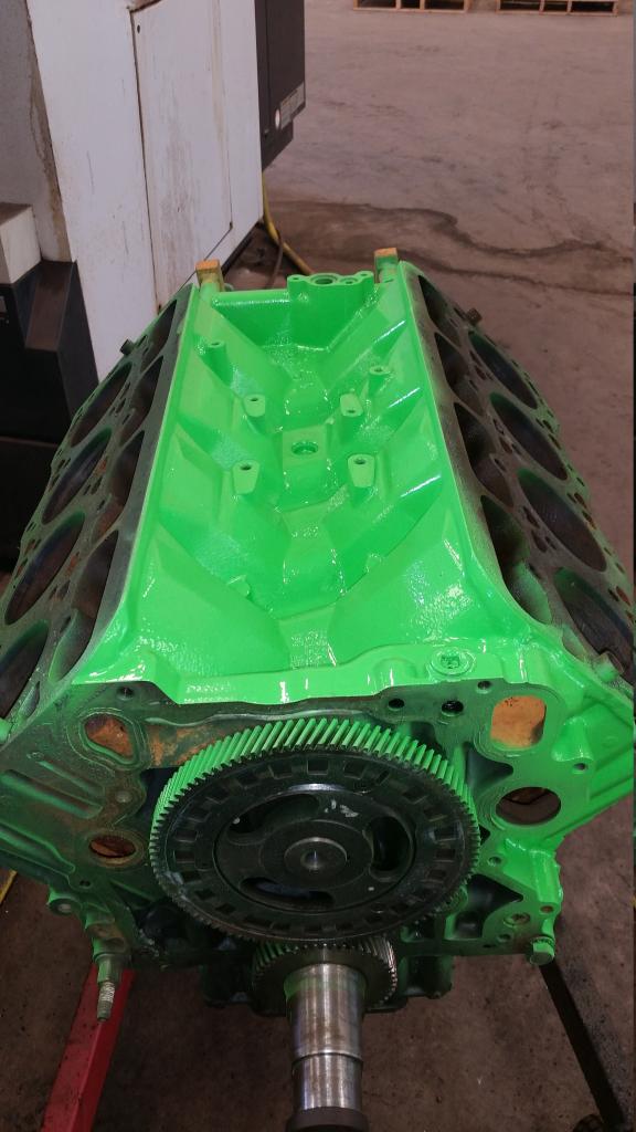

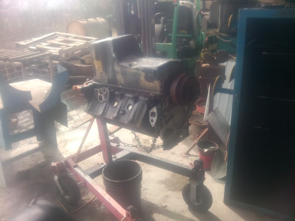

My blossoming paint application skills on display.
