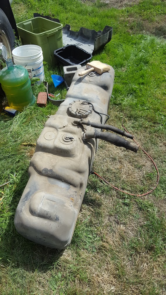

ok guys, fuel tank is officially out, is there some jig I can use to open the tank ? so I don't have to buy the tool ?
also, let's take bets on what we find inside, seriously there better be something wrong with this thing, lol

Old Jun 26, 2017 | 06:23 PM
  #36
bismic's Avatar
Joined: Mar 2017
Posts: 393
A strap wrench will work. A chisel (or even a large slot screw driver) and a hammer will work (carefully tap on the cap edge to rotate it). Go easy though.

Old Jun 26, 2017 | 09:14 PM
  #38
kodiak_f250's Avatar
Joined: May 2011
Posts: 44
what does harpoon modification do ? anyways, I opened it with a chisel, slowly and careful..
I pulled the insides out and didn't see anything wrong with it, that black pickup was all intact and looked good,
and I didn't see debris in the screen, going to put a stainless strap on that, so that it don't fall off in the future.
So I went back to the fuel pump, tested it while everything is out, to see the fuel flow,
I saw a nice jet coming back from the return fuel line inside the fuel tank.
The pump makes that gargling sound and I see bubbles come out into the fuel tank from the return line,
I cycled it like 10 time and while the bubbles decreased, that gargling sound was still there.
So I put the original pump back in, now I don't hear that gargling, but then again, I don't
see a jet of fuel coming back with the return line, lol...
So I am thinking that the original pump is busted, and the replacement pump is busted somehow different,
even tho it was new.... so looks like I have to buy a fuel pump.
So, again the original fuel pump is no longer making a gargling sound, I can hear it, its much quieter...
But I think with all the key on/off, I flooded the system, so I will try again tomorrow and see if it starts :- )
I feel like I am closer is getting things to work / must be the pump at this point...
Where can I get a good OEM pump ?
