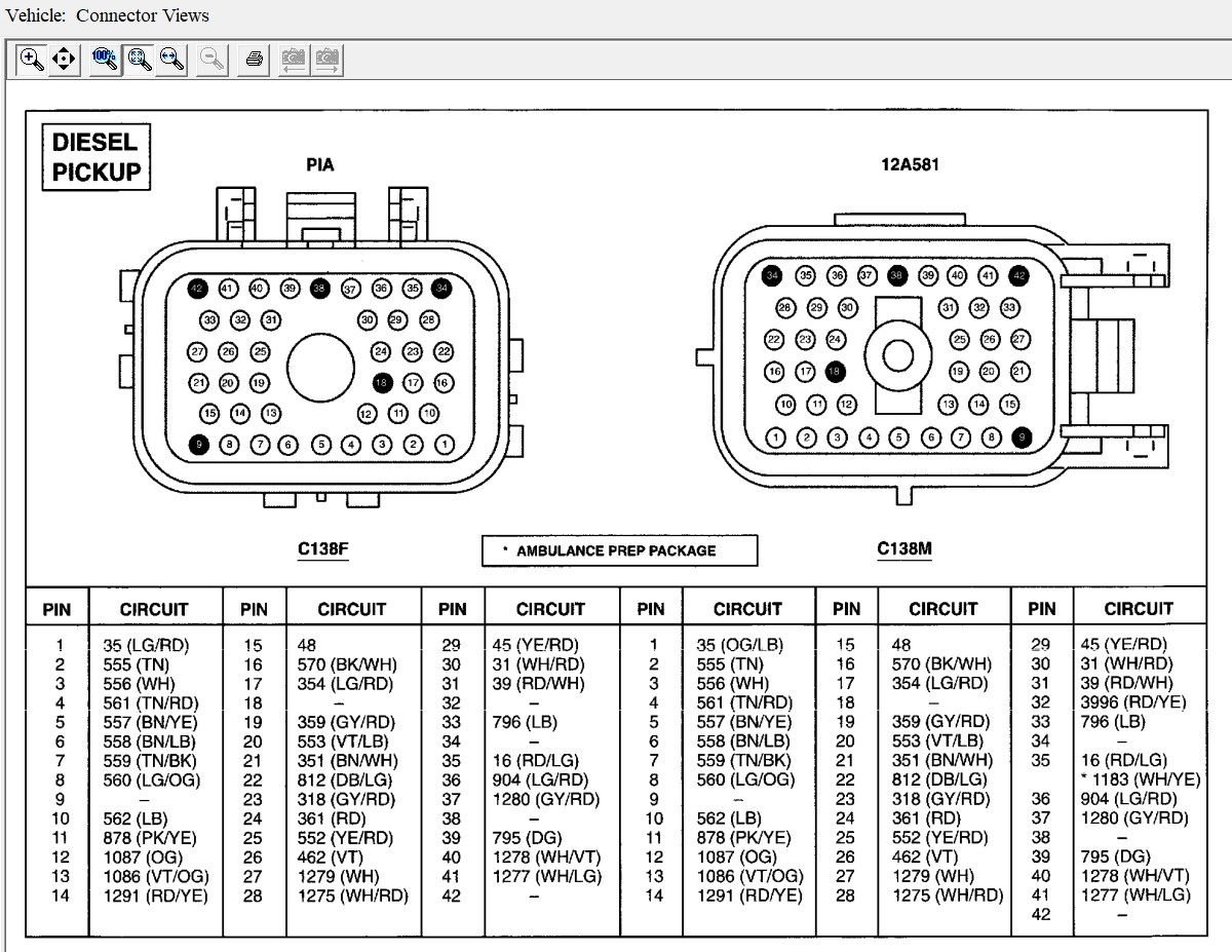

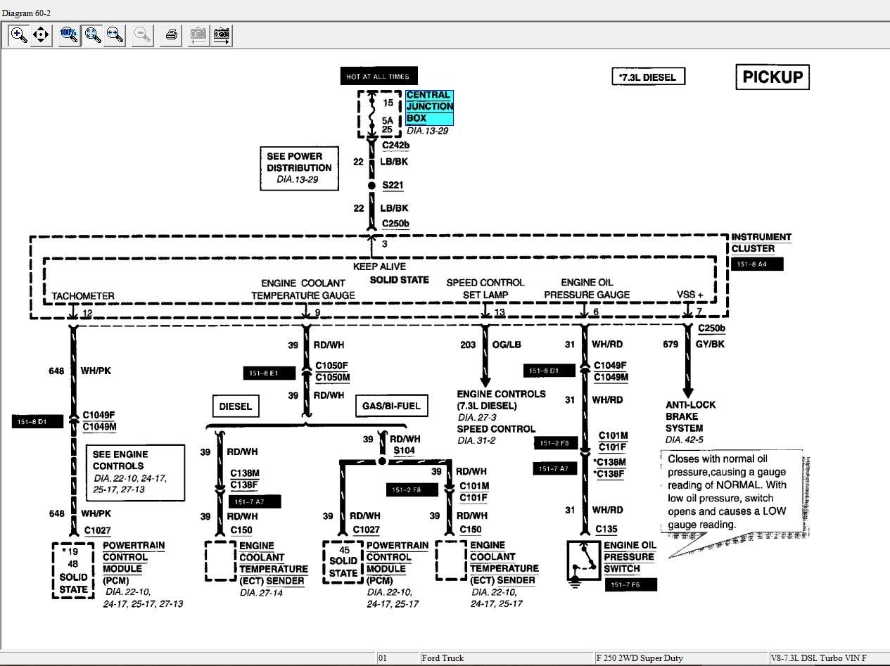

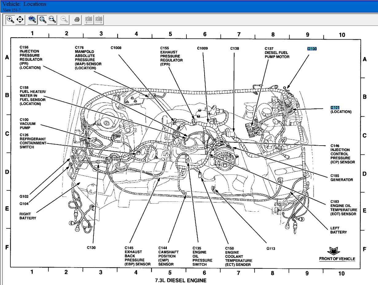

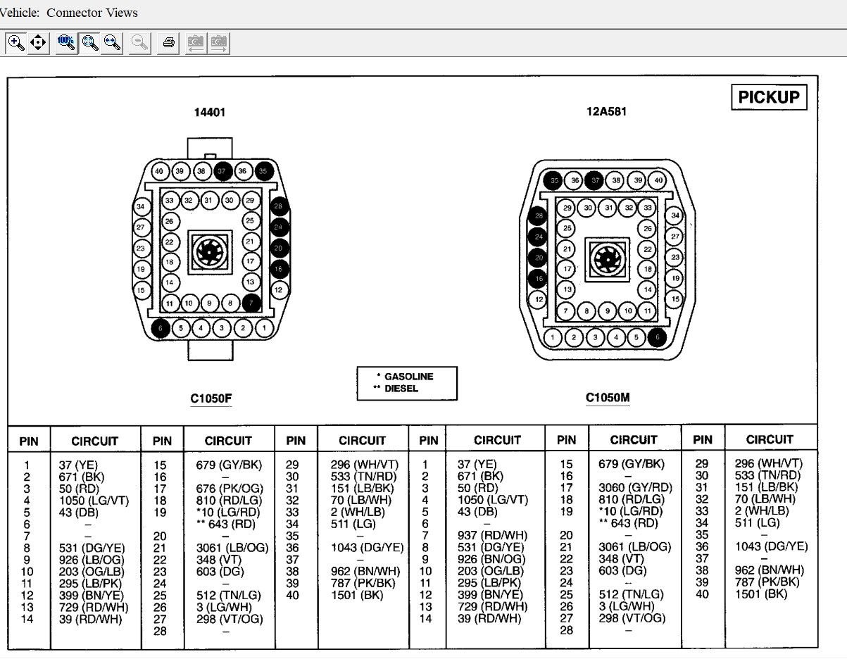

Locate C150, C1050 and C138 above.
Then C150 and C138 below.
C1050 below.
C1050 connector view above you can see pin 14 is circuit 39 with RD/WH (red/white).
C138 connector below, locate pin 31 on the same circuit 39.
You can test using multimeter and see if there is a break on your circuit 39.
BTW you have 2 C150s, the one you pulled could be for ECU as shown in 3 diagrams below. The one for instrument is shown above.
