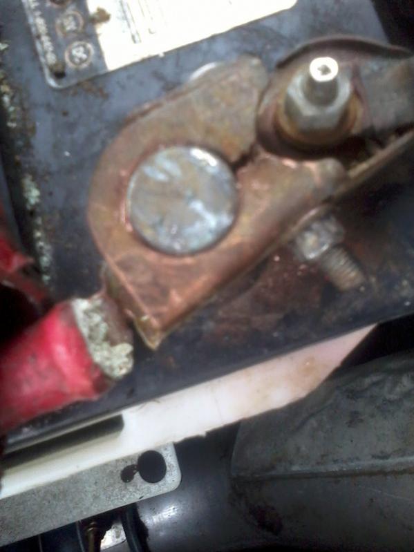

hmmmm, I tried that and nothing, but I did find something weird, the battery on the right, passenger side, the (+) side, where the cable feeds from the other battery, the terminal post seems cracked, like more than 1/2 way!
both batteries are needed to start the truck ? or just one ?
Also the battery icon is lit in the dash, before I start the truck, does that indicate some type of a battery problem ? or does that go away after the truck starts ?
I am attaching a picture from cell phone
thanks

The battery cable terminal is made that way. But, I did notice from your picture, the battery cable has much corrosion on it. That must be cleaned or it will destroy the cable. You can wash it off with a baking soda solution or just plain water. Because of the corrosion I don't know if the lower voltage is due to the corroded cable or the batteries are getting tired. In any case the cables have to be clean and in good condition or you could develop a multitude of problems. So much equipment on todays vehicles are dependent on the correct voltage to operate properly.
If the copper in the cable appears corroded away , it would be wise to replace the cable. If they are the original batteries it might not be a bad idea to replace them. Charging tired batteries will work for a short time , but they eventually will need to be replaced. After you get all the connections cleaned and in good condition , a little coating of grease on the terminals will help to keep the moisture and air from getting at them and encouraging the corrosion process. Also, if you are going to replace a battery, you should replace both because the charging system doesn't know which battery needs the charge and it will end up overcharging the good battery.

thanks for advice, I will do that with the cables, I charged the batteries overnight, to 11.5 volts now in position 4, and it wouldn't start, so am thinking it must be the cables that are the problem ?
did you see the crack in the terminal post ? that is supposed to be like that ? why ?
