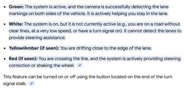

I can't find the answer to this anywhere in my owners manual. I have a 2024 F250 Lariat diesel. The icon in question sits adjacent and to the left of the vehicle direction indicator (NE in the attached photo). I have attempted to circle the icon I need to identify. As I am driving, I've noticed that it turns green sometimes and sometimes it is white (as in the attached photo). Can anyone tell me anything about this icon?

It's Lane-Keeping System indicator. Check here.
