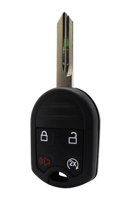

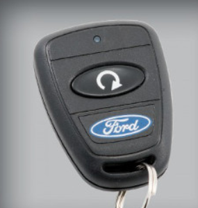

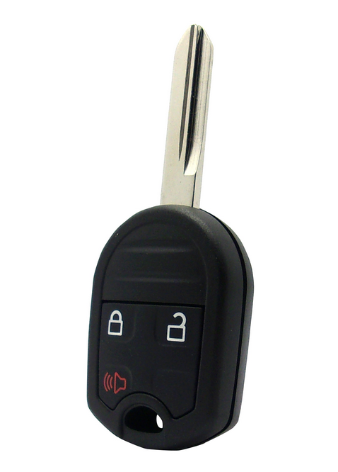

Here are pictures of a few Ford remotes, which ones do you have? If its not one of those post a picture of what you have.

Default First One
It is the first one in pics, door unlock,lock, and panic
