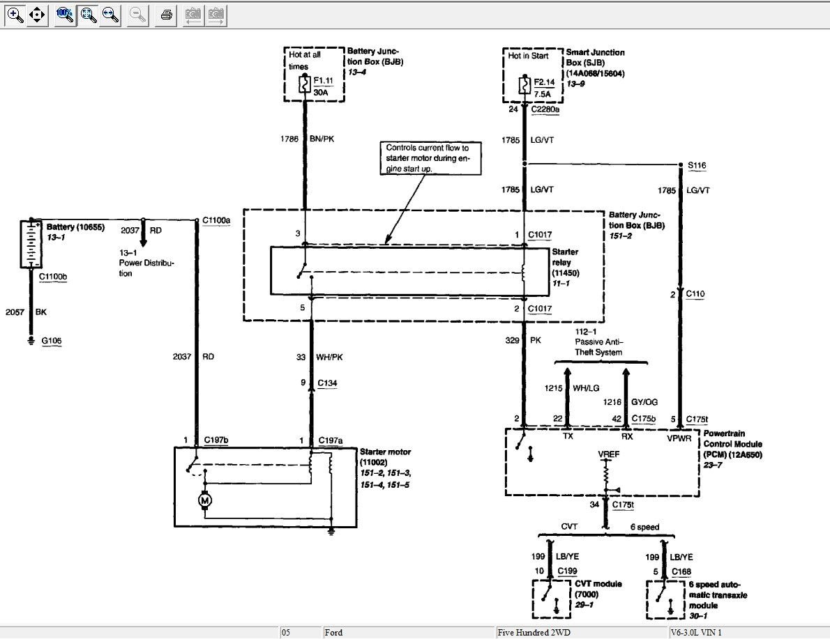

You will likely need to get your new PCM to program first, check PAT system in diagram below. In the meantime buy something like Innova 3630 Remote Starter Switch.

For diagnostic purposes you can bypass PAT system easily. I'd depin terminal 2 at PCM, the circuit 329 (PK wire), then connect a new wire to this PK wire to extend it, and ground it to chassis ground. On other Ford vehicles without PAT system, this PK wire is always grounded to chassis. Why you depin at PCM instead of BJB (where your starter relay connects to) because at PCM you depin and add a new wire (a dozen ways to add without cutting), at BJB you have to depin and repin to add, and your new wire doesn't have the exact same terminal crimped for you to repin back to BJB.
If bypassing PAT doesn't help, we can look elsewhere.
