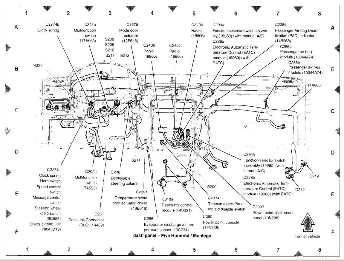

Any recommendations so I don't have to pull out the whole dash on a 2006? Thank you!!!

I tried to delete the post, but no delete button pops up. It was an accident due to having bad reception. Car is a 06 fwd ford 500 limited 3.0 duratec. Anyone have any advice on the easiest way to get to the sensor? Thx

Diagram for your car already enclosed, look at C296 it's not too far away from your gas pedal so you shouldn't even need to remove the dash to get to that. Last resort remove the radio panel you should have enough room to get to it.

So I removed the panels and radio and it's way up in the dash and can't get to it unfortunately. By the looks of the diagram it looks like it would be by where you said but it's way back there. So I disconnected the battery and turned on the lights to drain the capacitors and the AC works again lol.
