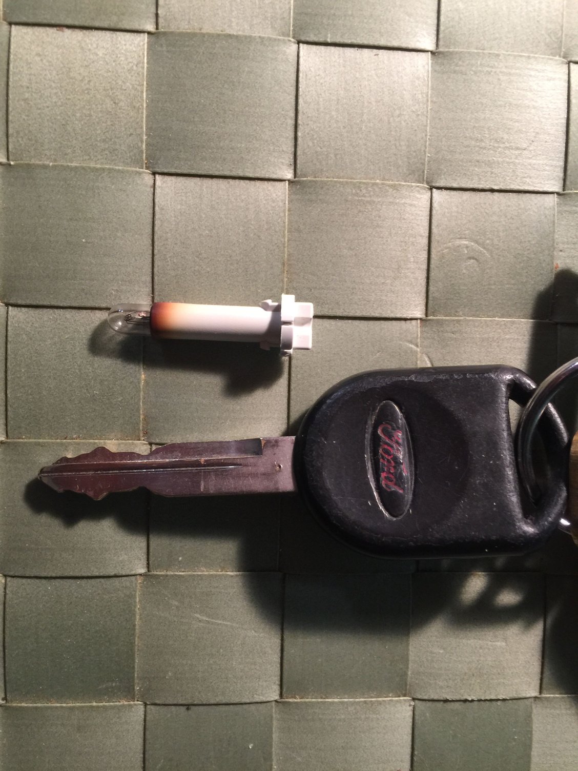

I noticed that the backlight in my headlight switch had burned out. Ford offers no replacement. I pulled the switch from the dash( very easy to do) and on the back of the switch is a bulb that 1/4 twists into place. Doing some searching on the net I cannot determine exactly what kind of bulb this is. Any help?

Never replaced one..
Bulb pull straight out?
If so, like the old clock,radio backlight etc micro bulbs Ford used, there are two different candle power bulbs. It may say printed on the bulb.
Looks like it’s suffered from some heat. May just be a lost connection, or bulb..

uncommon looking bulb for sure. Probably a wrecking yard project...
pain in the rear for such a small part
looks like the bulb has long leads that come out the bottom and bend around to make the connection

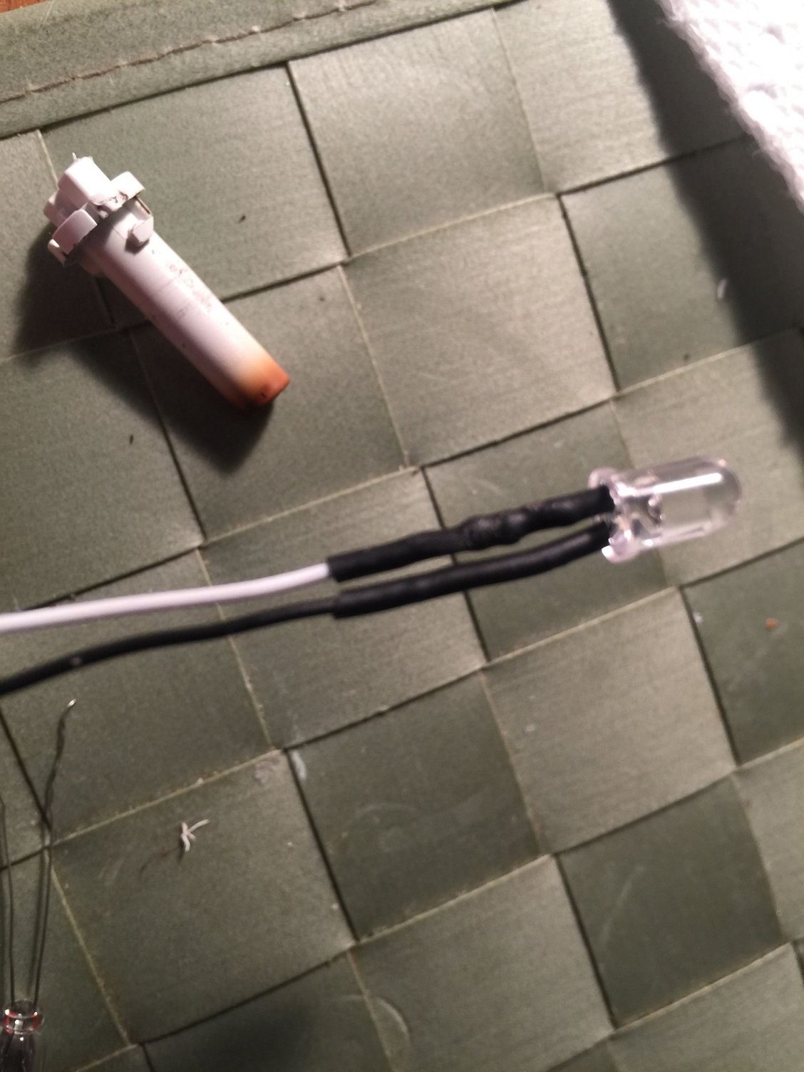

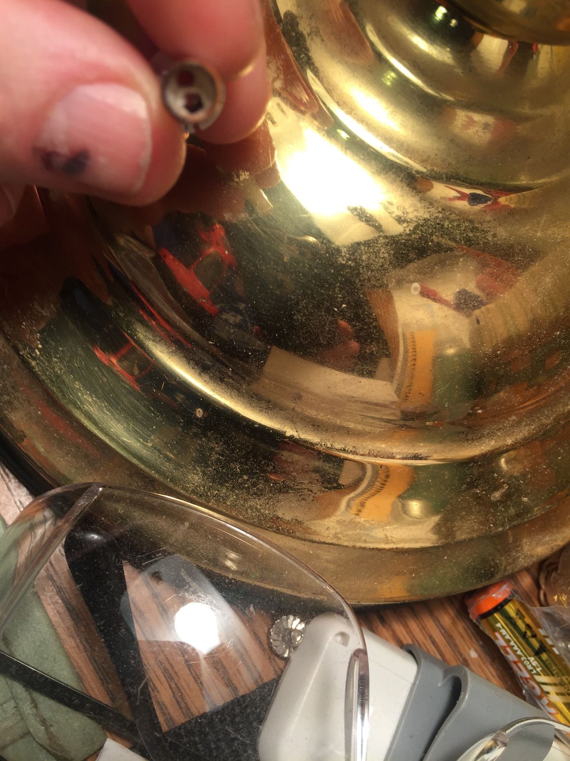

Pull old bulb from base
Drill out center holes with 3/32 bit

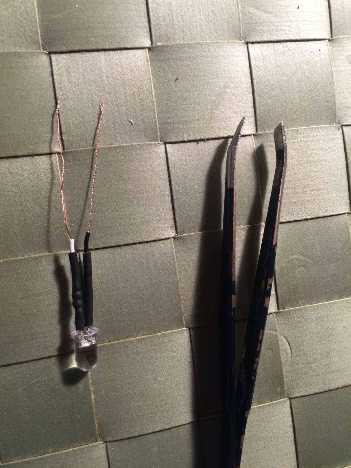

Got 50 of these with diodes already attatched and heat shrinked in place
Strip back insulation
Insert led in base and wrap around contact points just like original bulb

Those bulbs were from amazon . 50 pc 12v led 5mm. Only cost $8.56 and got them in 2 days. Perfect fit. Only took an hour start to finish .
