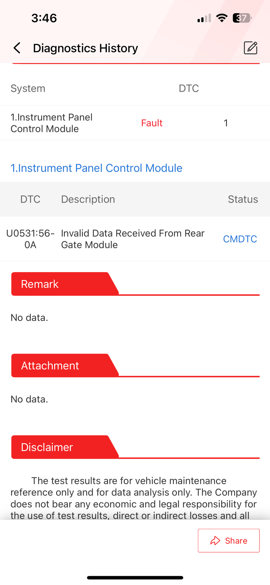

Even though it says invalid data from rear gate module and the code is coming from the ipc not the bcm

Don't panic on the DTC, once the module is reset it might not show up anymore. If your scanner has freeze frame data you can see when that U0531 was set, last week or yesterday based on the odometer reading.
