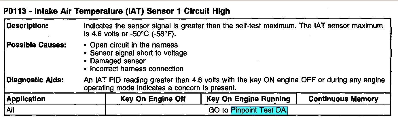

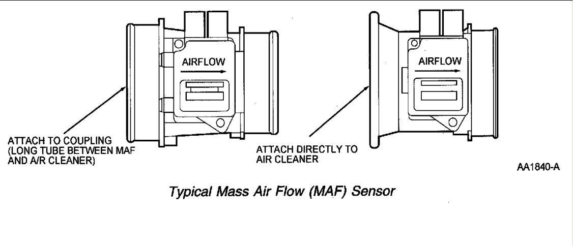

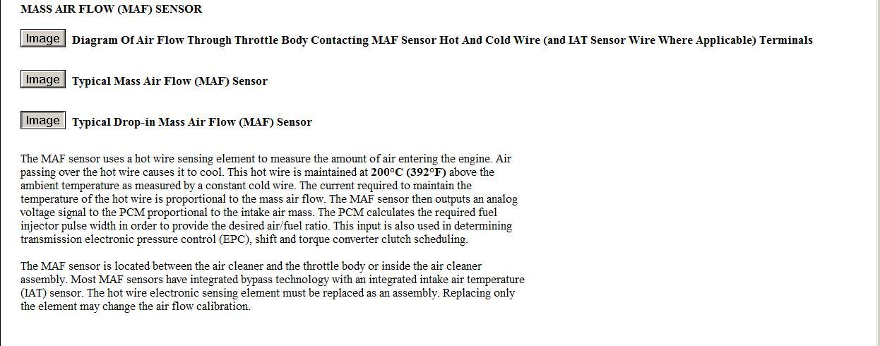

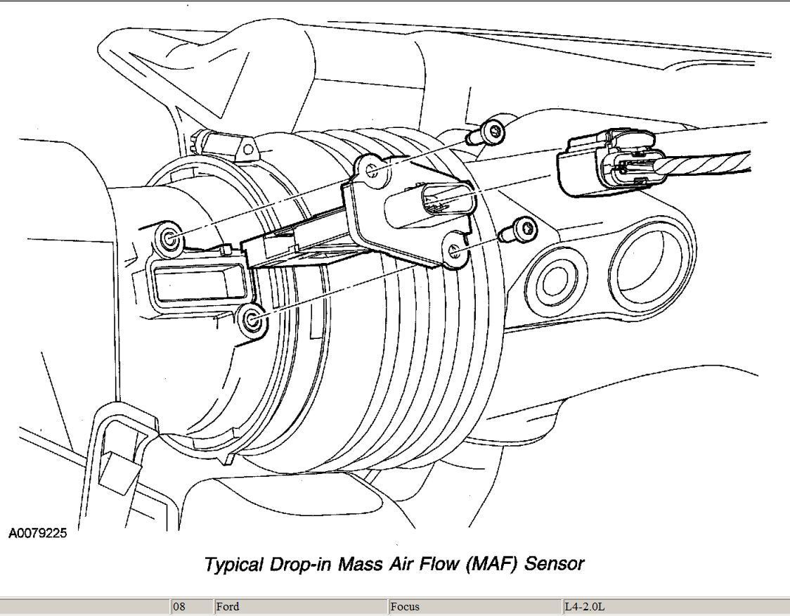

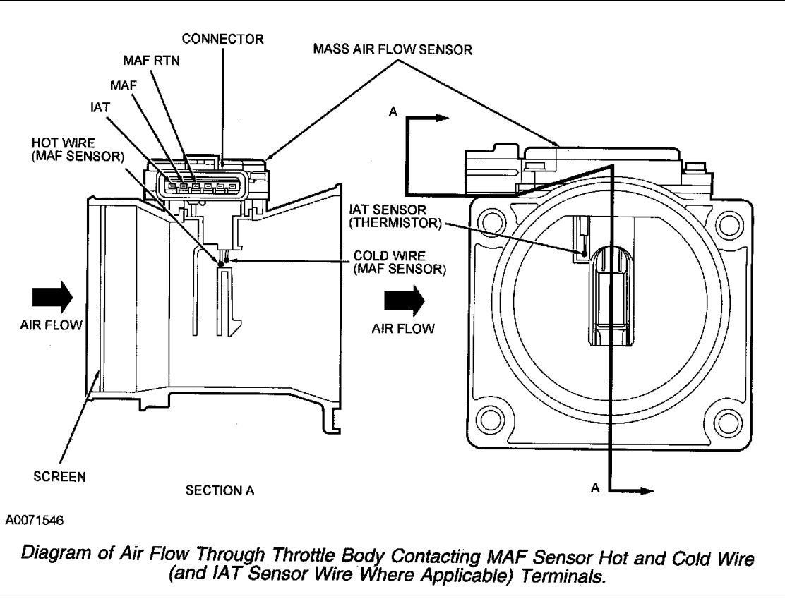

My alldata doesn't cover 2010, find below diagrams for a 2008:
1) Remove the electrical connector and check for any damage wiring, then use 91% isopropyl alcohol and clean the 6-pin connector (both ends male and female)
2) If you have a scanner or obd2 adapter that can read livedata look for IAT value in cold start and see if anything looks odd
3) Follow pinpoint test DA
4) Don't waste your time and money buying a MAF cleaner as it's for routine cleaning only, it can't rescue and fix a bad MAF.
5) If you need to buy a new sensor don't go cheap, buy Motorcraft AFLS131 at rockauto if that's the right one, coupon code: 318043252281634034 and ship to a commercial address for lower shipping rate.
