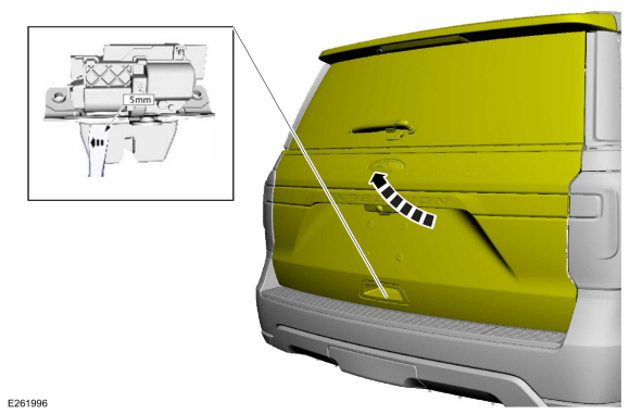

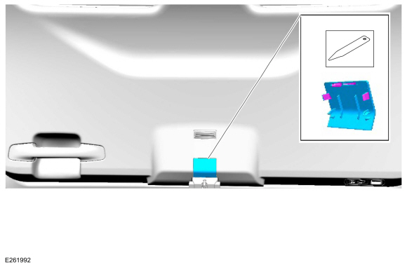

Liftgate Latch Manual Release
Special Tool(s) / General Equipment
Flat-Bladed Screwdriver Interior Trim RemoverActivation
All vehicles
  1. Open the liftgate window glass.
  1. Remove the liftgate latch access cover from the center of the liftgate trim panel.
    Use the General Equipment: Interior Trim Remover
Vehicles with power liftgate

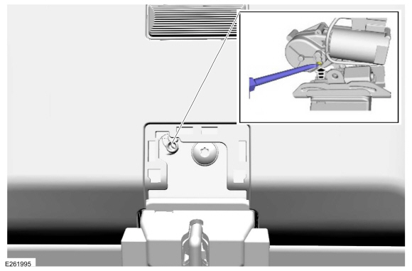

  1. Insert a flat-bladed screwdriver through the access cover opening and depress the cinch release button.
    Use the General Equipment: Flat-Bladed Screwdriver
All vehicles

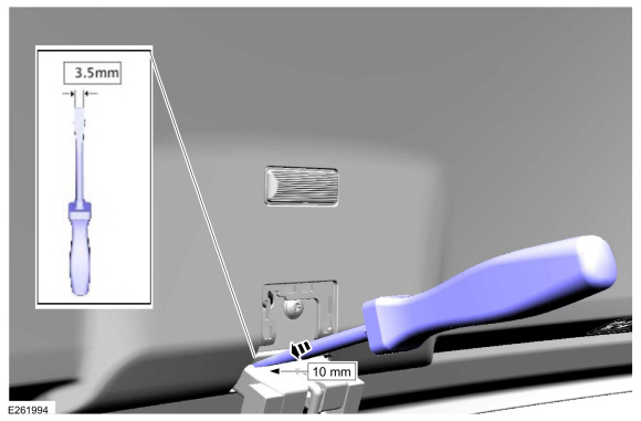

  1. Insert a 3.5 mm wide flat-bladed screwdriver through the access cover opening 10 mm deep into the RH side of the slot.
  1. NOTE: The liftgate window glass shown closed for clarity. The liftgate glass must remain open until the latch is released.
    Slide the 3.5 mm wide flat-bladed screwdriver through the access cover opening 5 mm to the LH side of the slot. Releasing the liftgate latch and opening the liftgate.

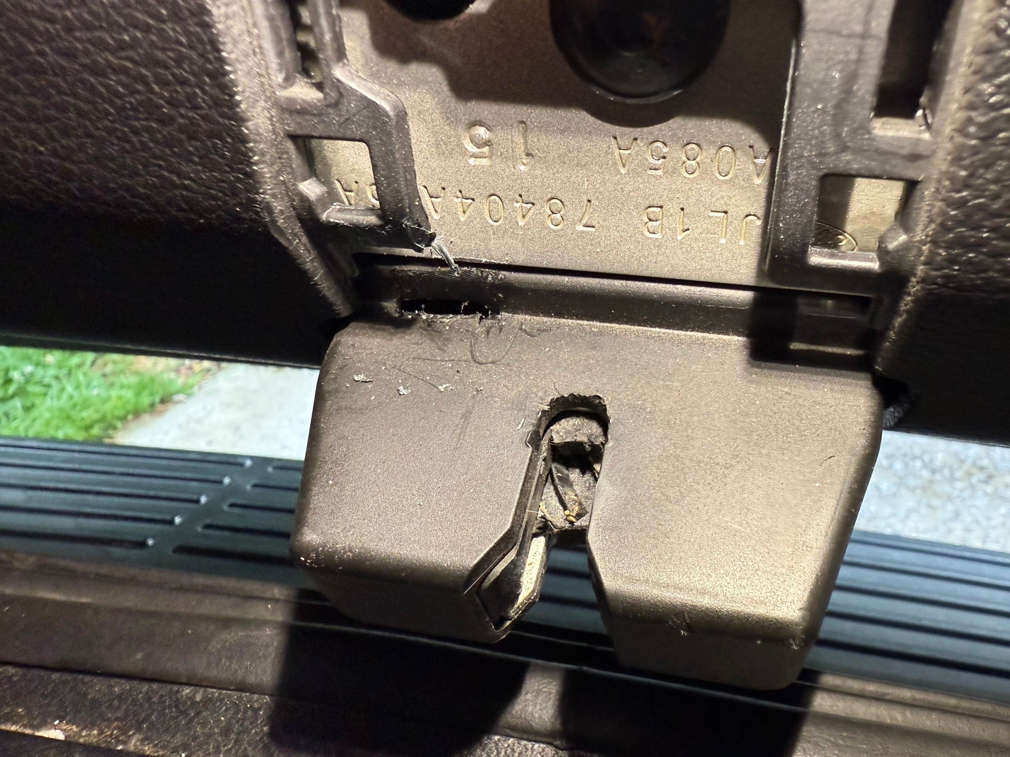

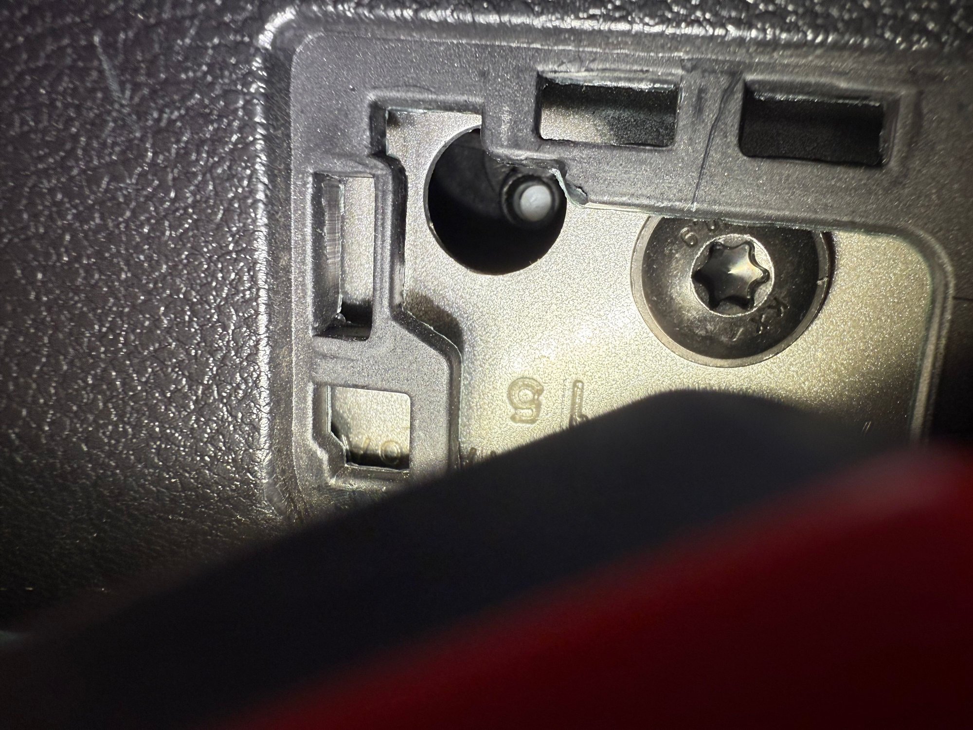

These instructions worked for me, but it took a few minutes to understand what it was saying for the second part.
Look for the damaged area in my picture. There is a very small slit in the plastic. Shove the screwdriver or pick preferably down then push left.
Press the white pin in with a curved pick
